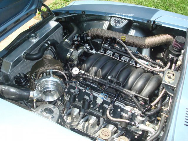

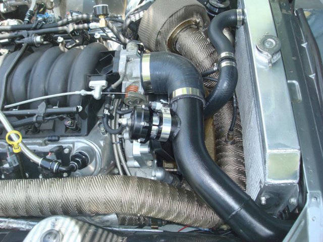

OK fellas, maybe some pics will calm this thread down. Here ya go!

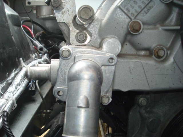

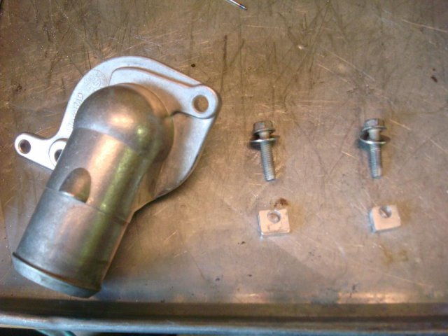

I saw this done on a LS1 swapped miata. Works great for rotating the thermostat housing down.

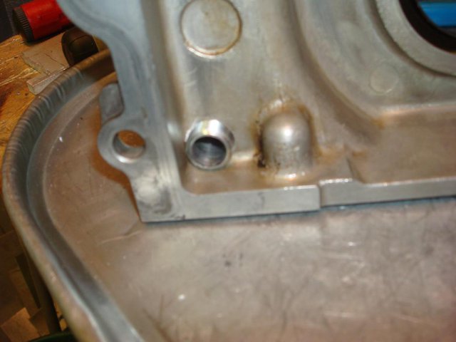

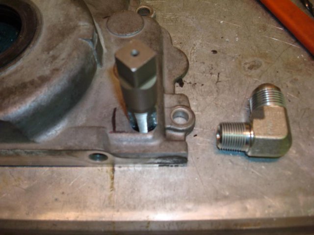

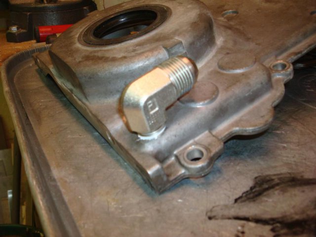

Drilled and tapped a 3/8 NPT hole in the timing cover for the oil return fitting. The fitting is a 90*  3/8 NPT to -10 AN
post-8245-0-45551500-1400438486_thumb.jpgpost-8245-0-15907400-1400438691_thumb.jpgpost-8245-0-98448300-1400438809_thumb.jpg

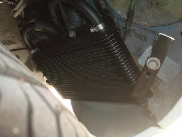

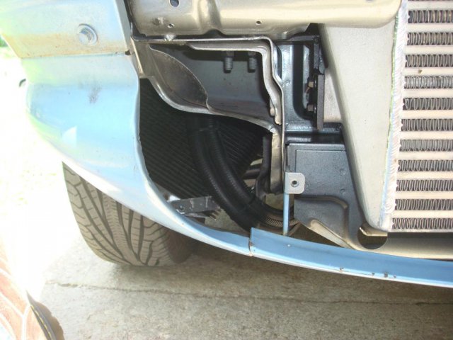

We had no room for the tranny cooler so it was relocated to the passengers wheel well. It should still get good airflow while moving but I might add a little fan later.

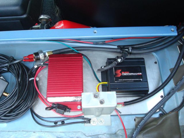

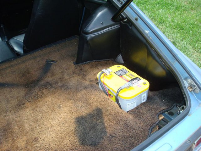

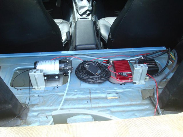

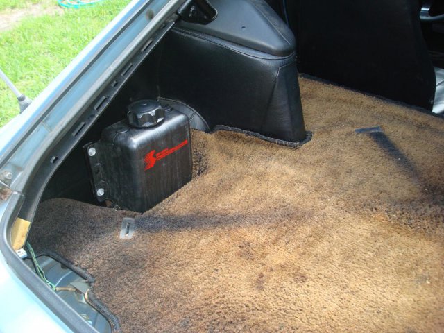

Hidden Snow meth kit and Kenny Bell boost-a-pump. Battery relocation
post-8245-0-57723300-1400439464_thumb.jpgpost-8245-0-32016100-1400439537_thumb.jpgpost-8245-0-56555400-1400439647_thumb.jpgpost-8245-0-45367700-1400439717_thumb.jpg

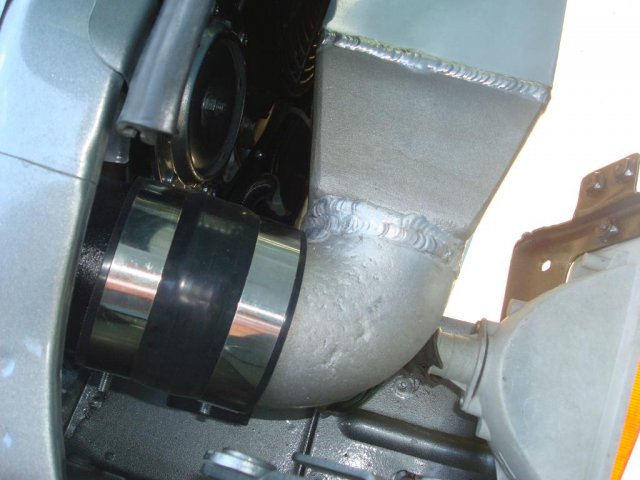

Finished kit
post-8245-0-42090700-1400439962_thumb.jpgpost-8245-0-19260400-1400440017_thumb.jpgpost-8245-0-74238900-1400440122_thumb.jpgpost-8245-0-56050300-1400440187_thumb.jpgpost-8245-0-15139200-1400440238_thumb.jpg

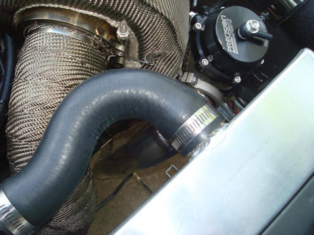

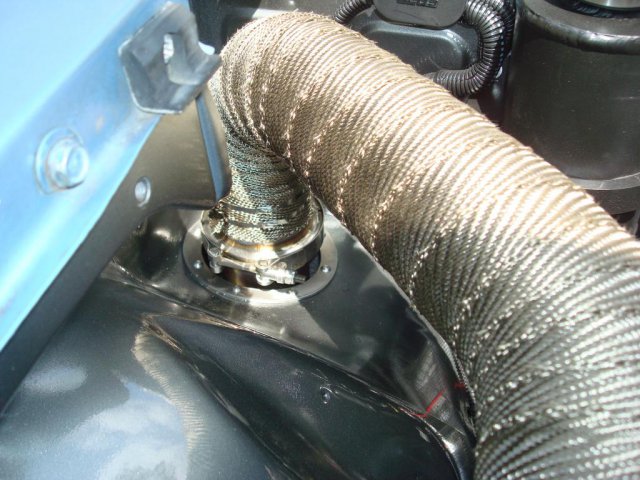

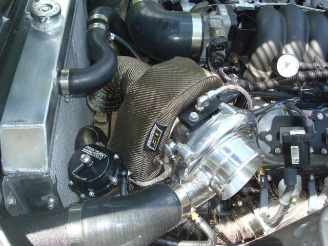

Downpipe
post-8245-0-82483000-1400440373_thumb.jpgpost-8245-0-56469800-1400440526_thumb.jpgpost-8245-0-49559100-1400440579_thumb.jpg
