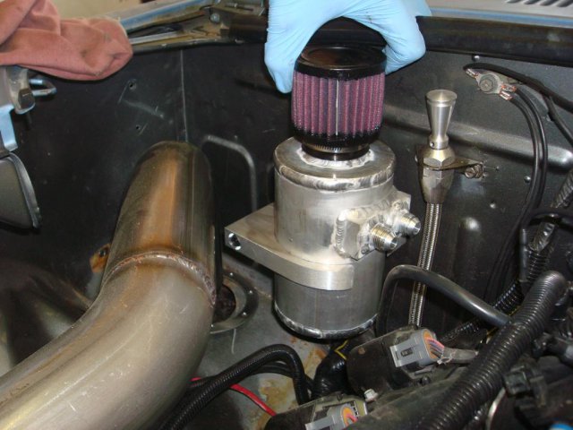

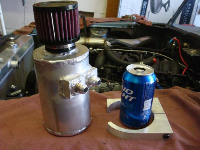

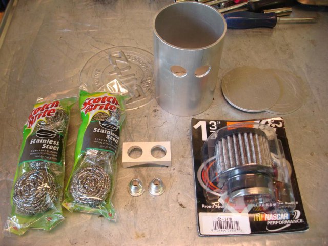

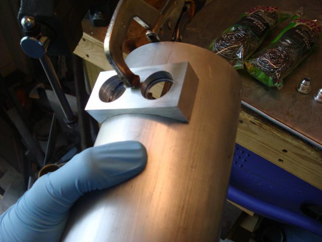

Made an oil catch can and two piece mount. It kinda looks like a minion, lol. Maybe I'll paint it yellow with jean overalls.
Parts and assembly
Finished product before powder coating.
I think I'll put here. Even though the downpipe will be wrapped, I thinks I'll go ahead and make a little heat shield for extra insurance.
