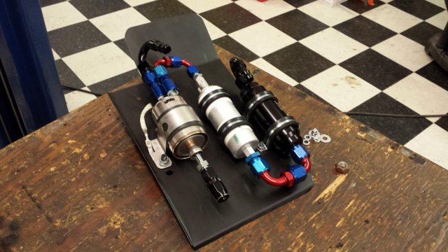

Right  now, I'd like feedback on the fuel setup - how much fuel starvation will I have and do I need to sump it?  Any concerns with my setup like heat soak or fuel starvation issues I can avoid?
Thanks in advance for the feedback

Mikey303- I had to check a few places on the routing of the C5 filter.  http://www.speedinc.com/ls1-ls2-lsx-conversion-fuel-filter-w-regulator-6-an.html
Finished routing my fuel lines last night- all hooked up. Now to disassemble and pump some cleaner through and reassemble. (tomorrow...)
