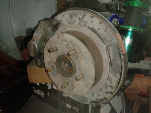

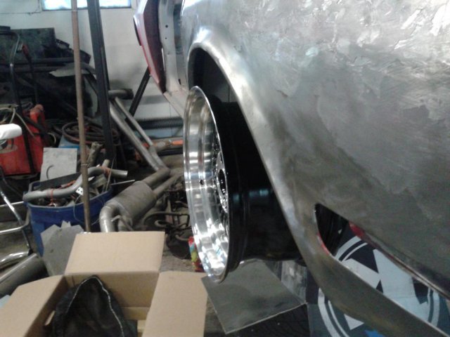

I ran into trouble fitting the 9" wide wheels with the brake calibers in place. Turns out the GTR double piston calibers come too much out and hit the rim already without any tweaking of the offset. With all the trouble with the fitment of these rims, I decided to try out the 8" wide rims, that were meant for the front. They clear the the caliber and the alignment with the fender is perfect. I can probably get away with some rolling of the inner lip. This will do for now, although I would have really wanted wider rims. I guess I'll just rethink the 3-piece rims someday.
Yes, I am aware of this and propably will go the custom three piece road someday. There is a good amount of back space, the GTR axle just don't allow for much lip on the rim or an ET typical for an RWD. The back space might allow for a 10" wide rim with a suitable offset.

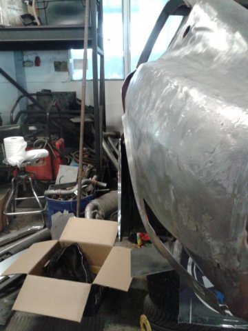

I decided to ditch the rear bumper and sheet metaled the holes. I guess you could say I reached a certain miles stone now, since all the sheet metal work of the visible surface just got finished. All of it related to the body widening anyways. I still need to figure out what to do with the bumper fixing points on the rear and seal up the nasty exhaust pipe opening.
Paint will still have to wait, though. At least the fuel cell mounts and the trunk floor will need to be fabricated along with the seat mounts before I coat her with some epoxy primer.
