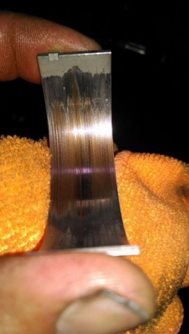

I pulled the motor on may 29th. Had bottom end issues. Slight Knocking. It was bairly noticable. But i heard it. Knowing I would want to DRIVE this car I wasent having it. Especially when the oil had a slight hint of metal. So as i wanted to do regardless I pulled the motor.
Found a bad bearing on #3 rod.

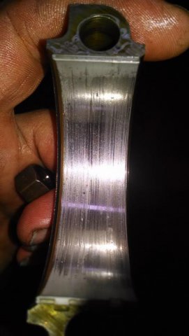

The rest look basically like this. Seems like damage from dirty oil. Im guessing a lack of oil on the #3. :/

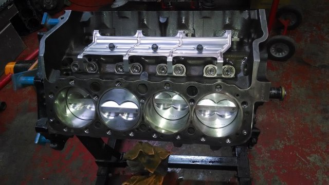

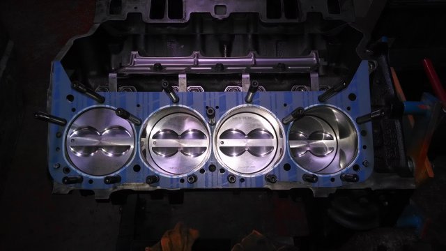

So i considered my options. I lucked out and found a sweet one piece rear main short block. Was told ruffly 3-4k on it. Has a decent rebuild in it. .30 over pistons, shot rods, Scat crank, balanced bottom end. Came with a Moroso drop pan. High flow pump and possibly a RV cam. According to paperwork i have its done by a shop in San Jose Ca.

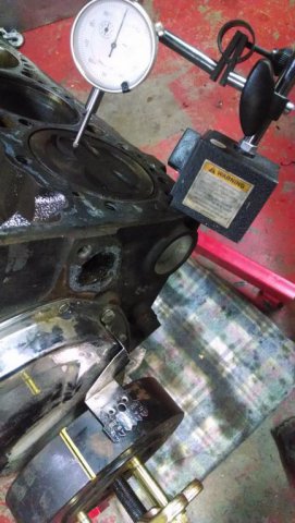

Moven right along, I stripped my motor and prepped everything for installation on the short block. I Picked up a nice stud kit for the heads. More of a cosmetic thing IMO for what im doing. :cool:

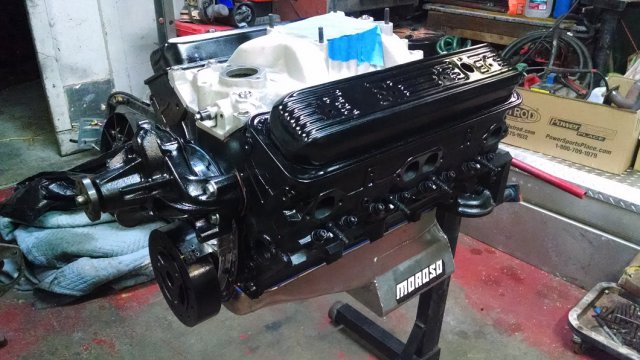

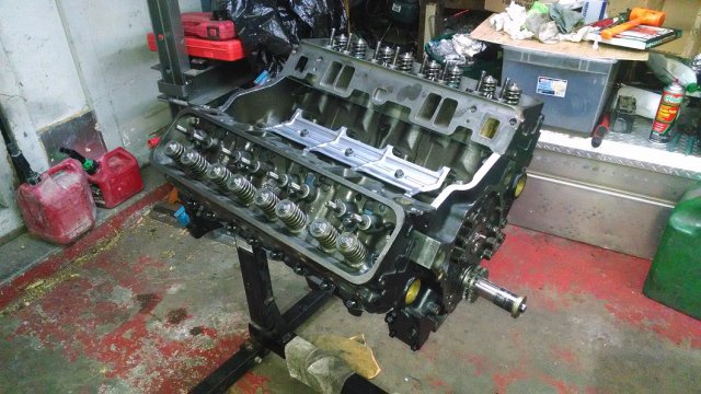

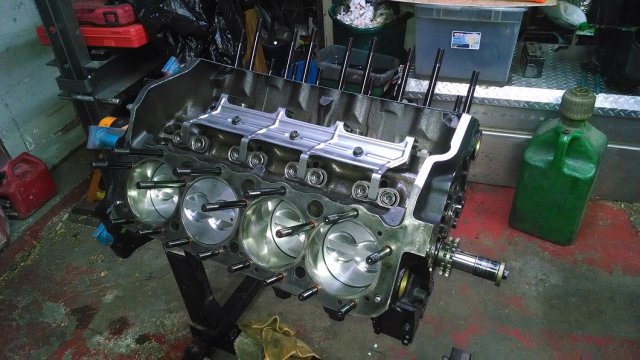

I went threw the heads and changed the stem seals as one was leaking. Also lapped the valves. I decided not to take them to the shop as everything was fine before with them. Poped them on and closed it up for that night.
After getting the valve train in and adjusted i finished up with the water pump,oil pump/pan, intake manifold and valve covers. New gaskets where needed. Have plans for an AN breather catch can setup down the road so im going to run the stock covers for now to save a few bucks. Here is a current pic of the motor as it sits waiting to be installed.

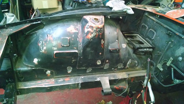

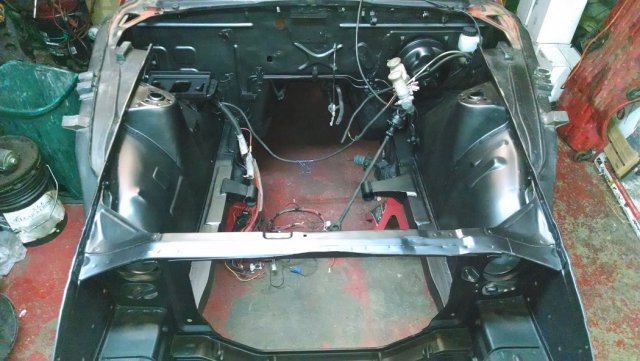

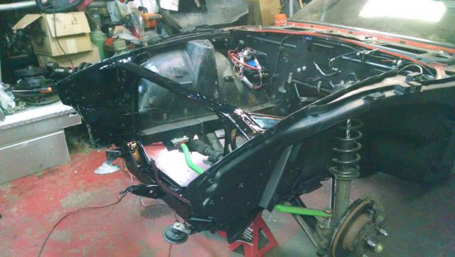

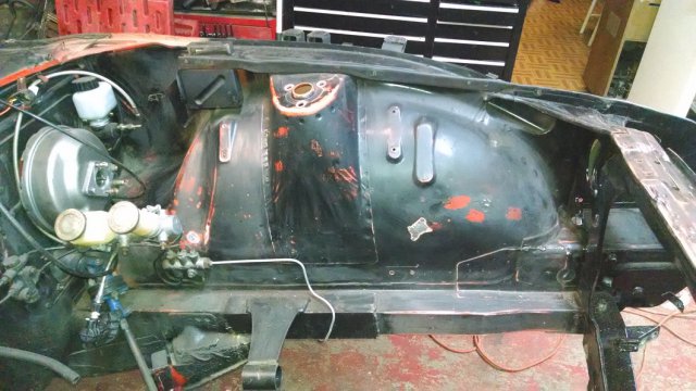

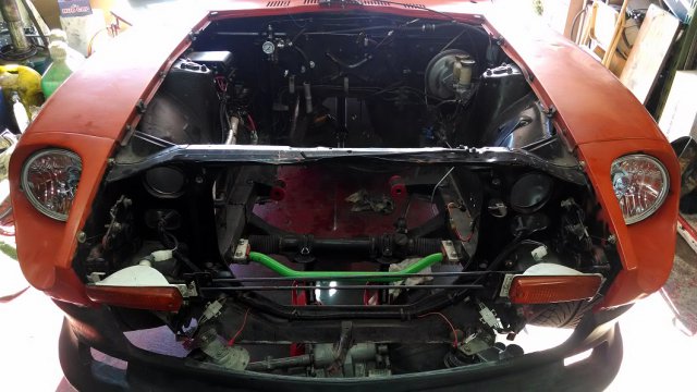

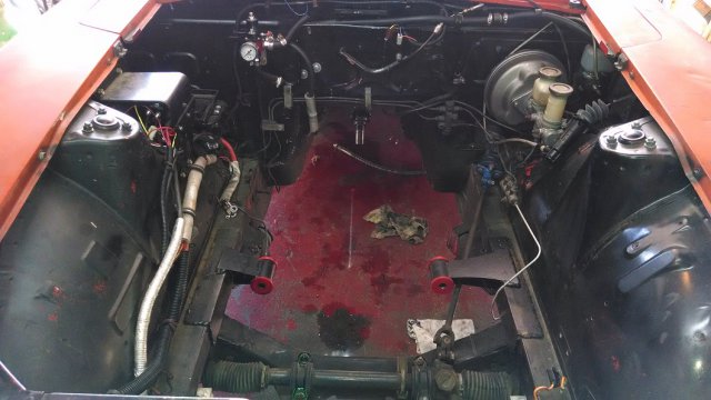

Once I got the motor setup for the most part I went after the motor bay. Basically cleaning it up. Cutting, welding, grinding and sanding. Filled and removed the extra hole and brackets. Took it down to a suitable surface to paint. Used a bit of filler to fix a few imperfections that stuck out.
BEFORE
PREP/CURRENT
Currently do minor touch up and then I will paint the final coats. Im just using Duplicolor High temp engine paint. Low gloss black to be exact. Feel if done right it will hold up better, longer from the heat of the bay. Apposed to the regular stuff $1.50 cheaper. My opinion only. Maybe Ill graduate to the paint gun one day.

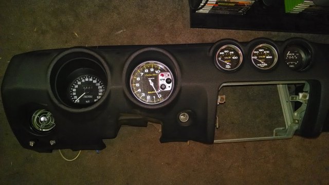

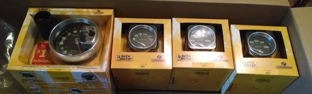

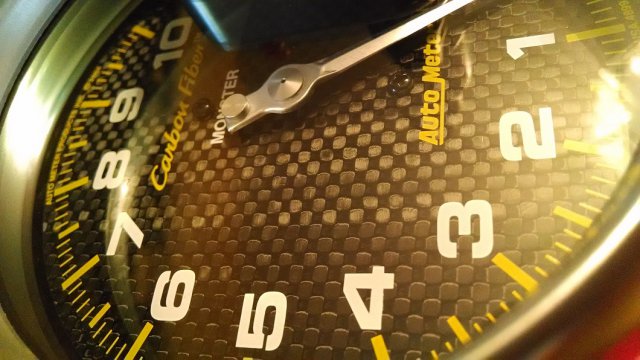

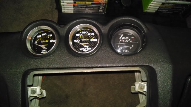

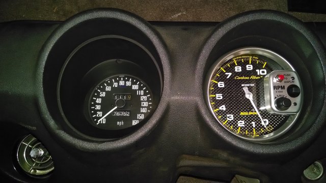

The car has a full Centech wiring harness. Which is done quite well besides the fact that the tail light dont work. And the back two markers. Anyway I pulled the dash as i plan to do some hush mat or something along those lines. Also to maby install my new GUAGES.
I do plan on getting the speedo but the setup would be a good $500 to get it running. Plus i found today the drive gear for the sender in the trans is missing. :/
Heres what config im going to run with for now.
