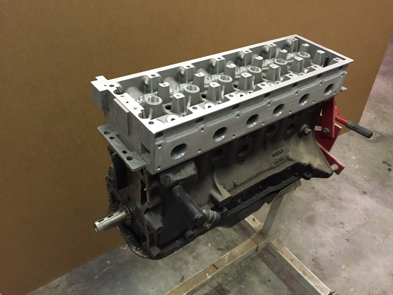

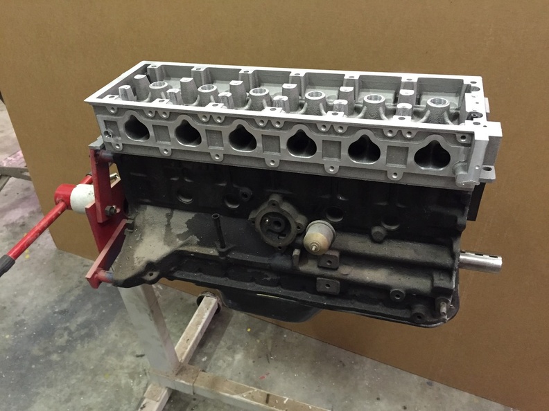

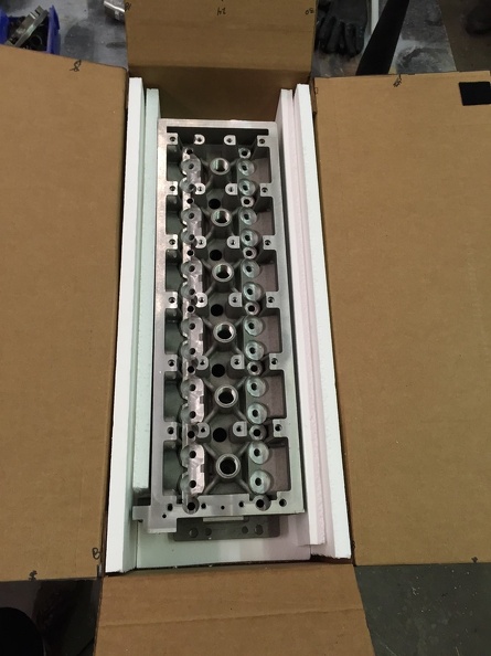

Machine work finished!   I can relax a little:) Just got done with their first bath. Still need de-buring and edge finishing but the majority of the work is done.
Yes, the exhaust port 'could' use some work, the as-cast cleaned intake is flowing within 10cfm of a 4 hour port job on an OS Giken head.   Those numbers outflow most max ported SOHC heads

Well it's out of the mill!
OOPS
Not enough clearance for the tool holder.
Well that's it for a week or two. Got a bunch of pattern work that backed up so I have to get a handle on that.  Also realized I need the front timing cover done before I have the head surfaced. I may machine that out of billet 6061 as I'm not too sure if the production heads will have the water outlet coming out of the front.
I guess I could have cleaned that block up a bit :)
Edited by Derek
Looks surprisingly like my KA 6 cylinder head.....
How about now :)
Well, that's it.  It's ruined.
Send it to me and I'll dispose of it properly.  I'll even waive the disposal fee.
So nice of you. It'll go out today

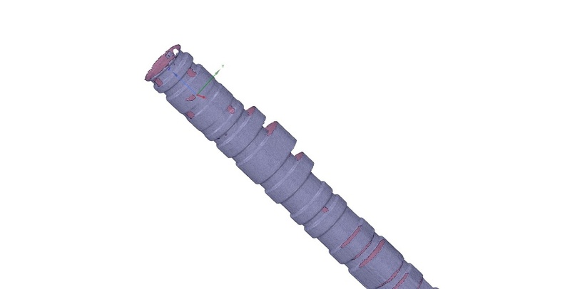

Cam scan

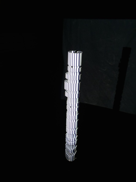

Well everyone in the brain trust agreed that the numbers on the K20A2 cams would be a good starting point for my motor. I bought a used set of cams off of ebay. I used my structured light scanner to capture the lobe data.
The scanner projects a light pattern against the object and photographs that pattern The software creates a mesh from the pictures. Here is a shot of a single pattern to give you an idea. I painted the cam white for a better scan.

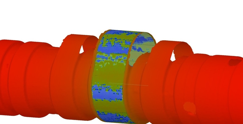

This is the resulting mesh. The mesh has holes as I only capture as much data as I need.

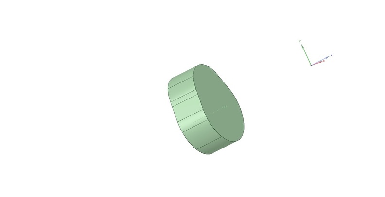

I run a plane through the lobe so I can derive curves.
And use those curves to develop a solid model.
I can then use the deviation calculator to see where I'm at but I can usually tell if I'm off or not as I'm drawing it. On a larger project it's nice just to make sure I didn't miss a feature.
Now I can start designing the cam core blanks and patterns.
Edited by Derek
