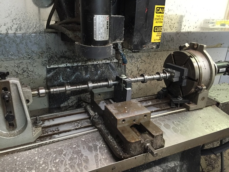

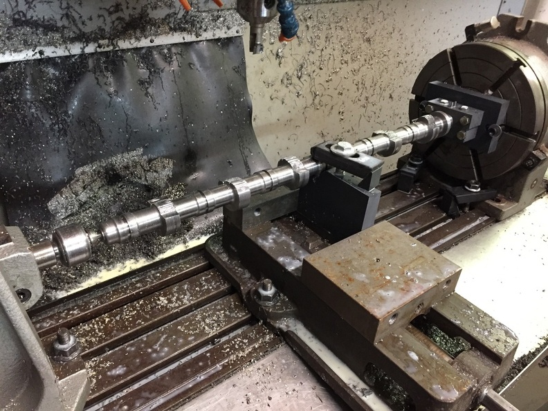

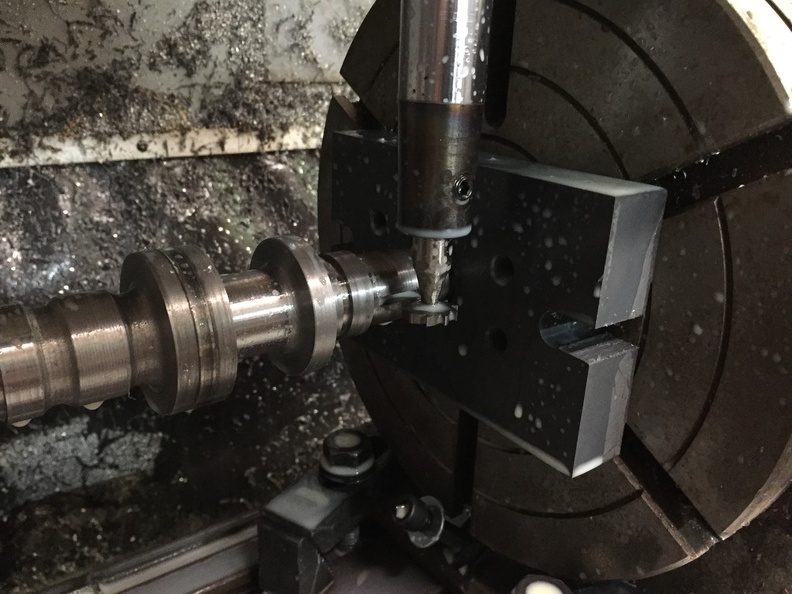

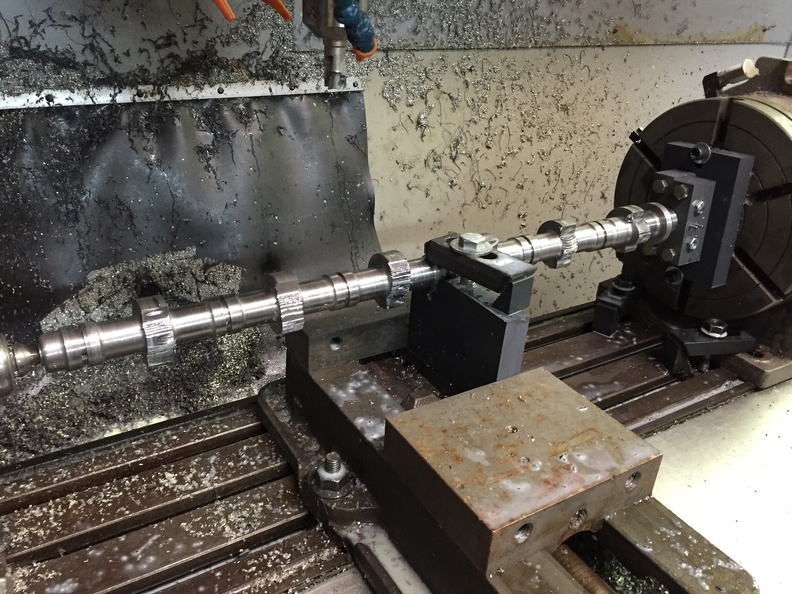

Derek 66 Posted September 19, 2015 Author Share Posted September 19, 2015 (edited) Lobe work Got the 4th axis back up in the mill and decided it was time to do the lobes. My plan is to rough it out on one plane then rotate 90 degrees and rough again. Repeat at 180 and 270 degrees. I’m hoping there is enough material removed at that point to go straight to the grinder. First step key slot. After this is done I have a fixture that clamps on the front and keeps the cam indexed to the 4th axis. I machined a V block in line with the centerline of the cam and added a clamp. This is way too long to machine without a center support. First cut! This is after the first roughing pass. I’m using .035 depth of cut which is leaving a bit of a step. I may make it a little less on the next cut. If I decide to do a finish pass that will all go away. Here I’ve rotated it 90 degrees. I also rotate it in my CAM program so it’s looking at it from the new direction when I calculate the new code. 4th axis work can be tricky if everything isn’t setup properly. That's it till Monday. Edited July 7, 2017 by Derek 1 Quote Link to post Share on other sites
1 fast z 4 Posted September 20, 2015 Share Posted September 20, 2015 Why not run the A axis simultaneously? Quote Link to post Share on other sites
Derek 66 Posted September 20, 2015 Author Share Posted September 20, 2015 My steady rest from the lathe is too tall for my A axis and I wasn't comfortable doing continuous motion roughing with just a V block and friction clamp. I'll do it on the finish pass. If I continue to make cores I'll make a steady for the 4th axis and go to town. Derek Quote Link to post Share on other sites

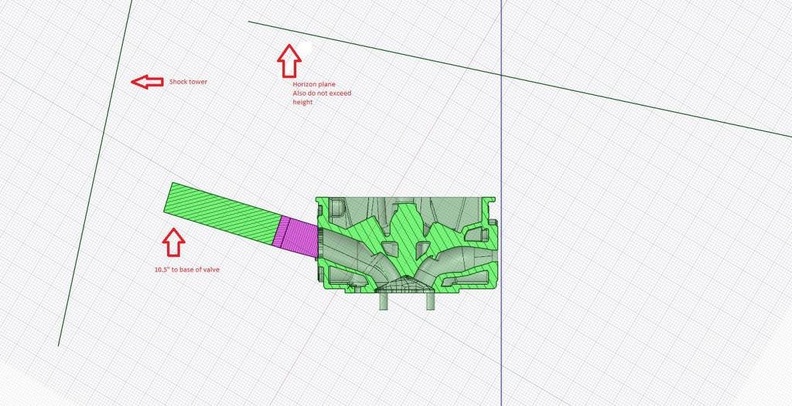

texis30O 26 Posted September 24, 2015 Share Posted September 24, 2015 As always Excellent work! I am interested to see what you do with the intake runner lengths. Quote Link to post Share on other sites
1969honda 2 Posted September 24, 2015 Share Posted September 24, 2015 Just *wasted* the better part of the day at work catching up on this entire thread. WOW, really inspiring and cool stuff going on Derek. Very cool, can't wait to see the final outcome. Quote Link to post Share on other sites
Derek 66 Posted September 25, 2015 Author Share Posted September 25, 2015 (edited) As always Excellent work! I am interested to see what you do with the intake runner lengths. Thanks. Xnke worked out the header design and came up with the intake length. 10.5" to the base of the valve including throttle body, velocity stack and manifold. Manifold is 2.125" long. Just *wasted* the better part of the day at work catching up on this entire thread. WOW, really inspiring and cool stuff going on Derek. Very cool, can't wait to see the final outcome. Thanks Yea it can be a bit of a time vampire! Edited July 7, 2017 by Derek Quote Link to post Share on other sites
