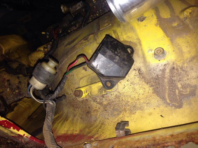

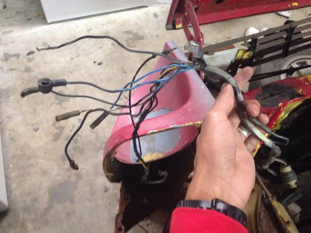

victorjr24 0 Posted November 21, 2014 Author Share Posted November 21, 2014 I am still working on my swap wiring, can anybody identify what this black boxe is and also what these wires go to. They were cut before I bought the car and idk what they are. I don't have to much left in the swap besides these wires and figuring what hoses are needed Quote Link to post Share on other sites
victorjr24 0 Posted November 24, 2014 Author Share Posted November 24, 2014 Does anyone have an idea of what they connect to? Or if they are needed? Quote Link to post Share on other sites
NewZed 85 Posted November 25, 2014 Share Posted November 25, 2014 EE-29 and -45 show some possibilities. Quote Link to post Share on other sites
Driftinrican 0 Posted March 3, 2015 Share Posted March 3, 2015 I am still working on my swap wiring, can anybody identify what this black boxe is and also what these wires go to. They were cut before I bought the car and idk what they are. I don't have to much left in the swap besides these wires and figuring what hoses are needed That black box has to do with the distributor I don't know how you are doing your ignition set up. Are you using the et distributor or using coil packs. Mega squirt or factory harnesses. As far as from an OE stand point of I'm not mistaken that box connects to the ignition coil to determine the firing rate of the coil. Quote Link to post Share on other sites
cygnusx1 12 Posted March 7, 2015 Share Posted March 7, 2015 http://forums.hybridz.org/files/file/4-turbo-swap-wiring-diagram/ Quote Link to post Share on other sites
Pac_Man 0 Posted March 8, 2015 Share Posted March 8, 2015 Most of the extra stuff you'll end up with has to do with accessories such as headlight cleaners and the like. As long as your ignition and EMS are wired correctly and the car starts and runs normally, everything else is just about guaranteed to be extra. I'm curious about that black box, though. If it is for the distributor, maybe it's a signal converter for the digital dash models? Quote Link to post Share on other sites
