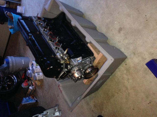

After all that work I ran it twice and broke the crank. I think the clutch was out of balance for a long time and eventually wore it out.
I sent it off and had a new crank nitrided, eliminated the distributor and went with individual coils, did away with the flywheel and went with a flex plate and got a Quarter Master Pro 5.5 clutch. I haven't had time to put it back together but will post up when I do
