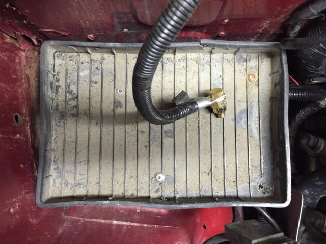

Wow - I just can't imagine buying a battery that lasts only maybe 3 years - unless it's for a purpose built race car. I bought the Optima back in 2002 because I'd heard they last a long time. Fortunately it was before they changed ownership and it lasted almost 14 years.  I'm in the process of replacing the lead-acid battery in my Suburban.  It's a 2002 and it's second battery is getting too weak after almost 9 years. It was an Autolite. I'm replacing it with a 7 year warranty battery that I fully expect to get 7-8 years out of. I'm investing in the Braille for my LS1 280Z because i figure it will probably be the last battery I'll have to buy for it.  I've had the car for 24 years now.
Pulled the Optima out of it yesterday and took a shot of the original stock 1977 battery tray. A little dirt but not bad for 39 years of service.  First time I've seen it since 2002.
May have to do something about the funk in the upper left-hand corner though.
