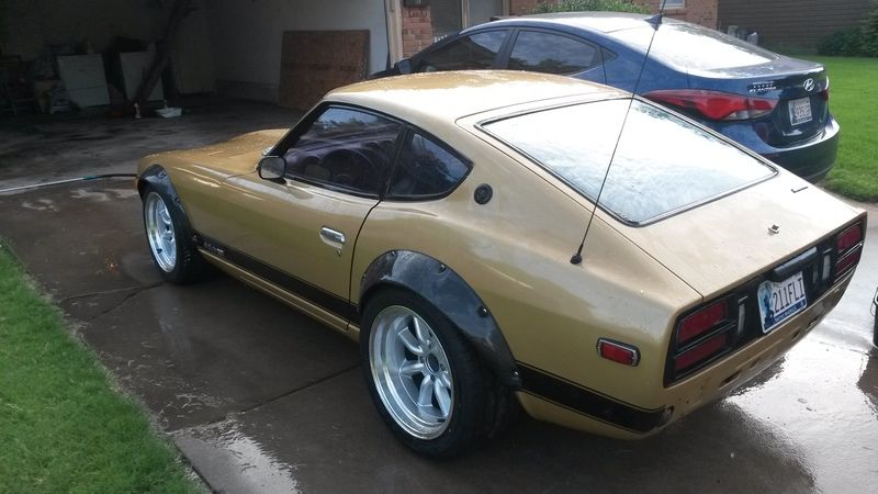

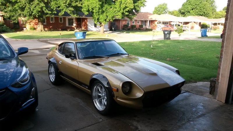

Looking pretty damn good man!
You should see how my shifter sits without the extension haha, I'm going to have to modify the console and move the whole thing forwards towards the nose of the car just to make it clear. And put an S bend in the shifter as well probably.

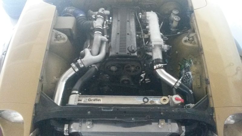

Out of curiosity what dimensions did you go with for your radiator / intercooler. I'm having troubles finding a manufacturer that make them to fit, either too big or too small. I'll probably end up getting one custom.

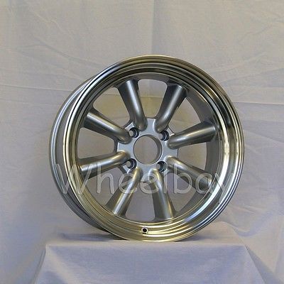

Loving the wheels as well.

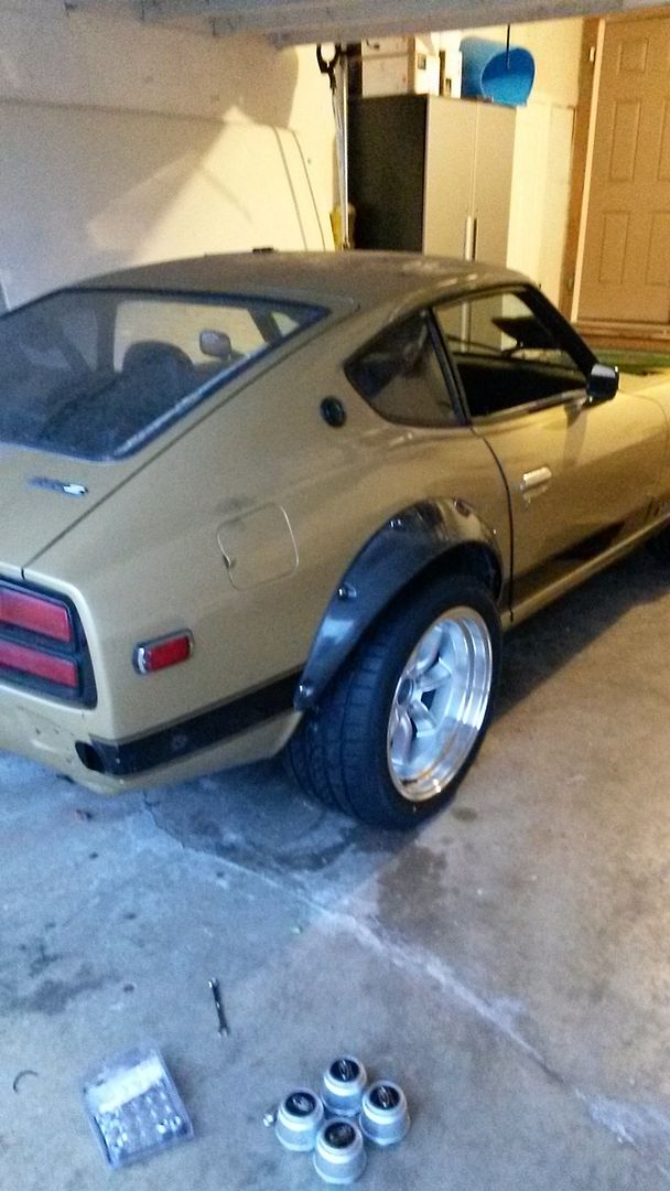

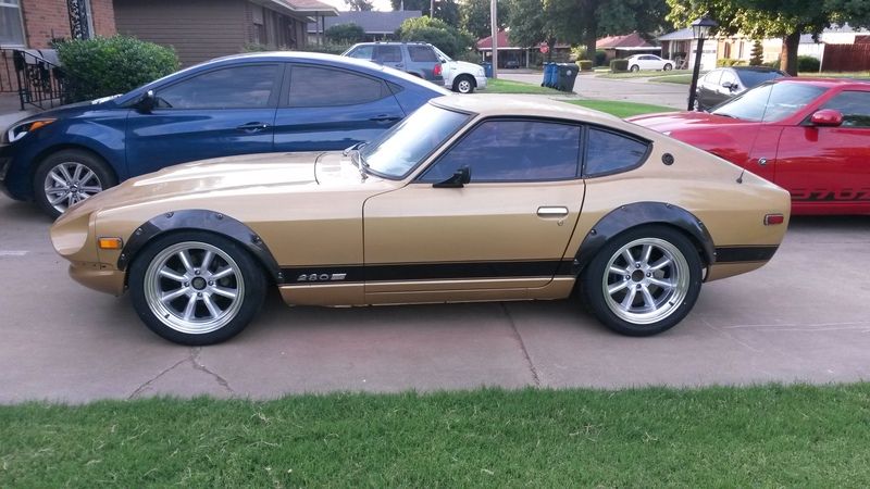

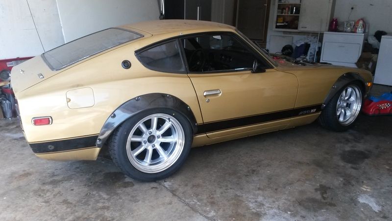

I went with the 17x9.5 -20 rear and 17x8.5 -10 front. 275/40/17 rear tire, and 235/45/17 front tire.

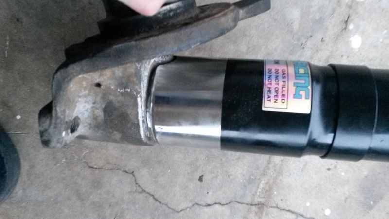

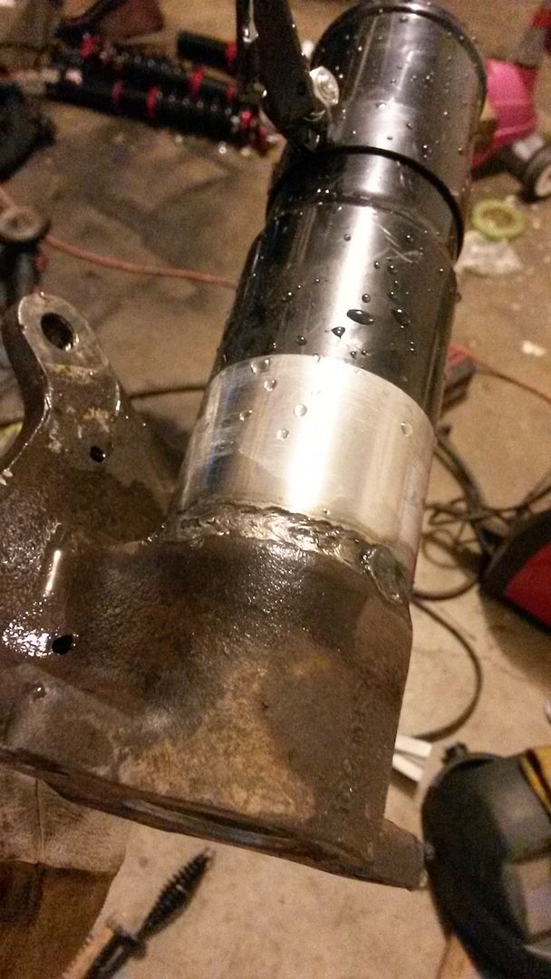

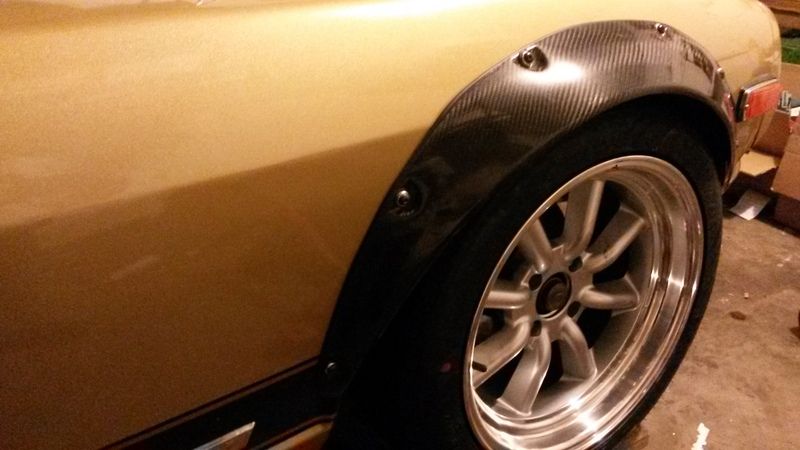

Man, installing the fronts, you can get a weld pretty much around, the rear I could only get 3/4 away around. Maybe I will drill a hole and bolt it for extra per caution

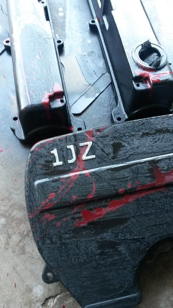

I started to paint my valve covers. Going for a wrinkle black with blood splatter. See how artsy I am. =)

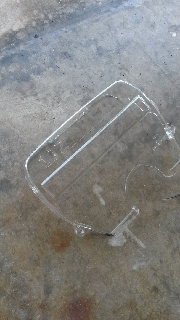

Here is what I ordered clear cover. I plan to have the "1jz" see threw. Paint is wet, so I couldn't miss with that just yet.

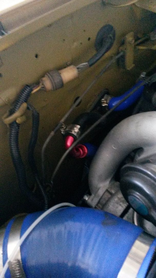

Oh, I finally can put coolant in it too!
(After I put hose clamps on)

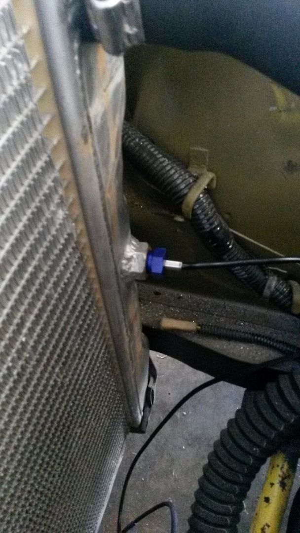

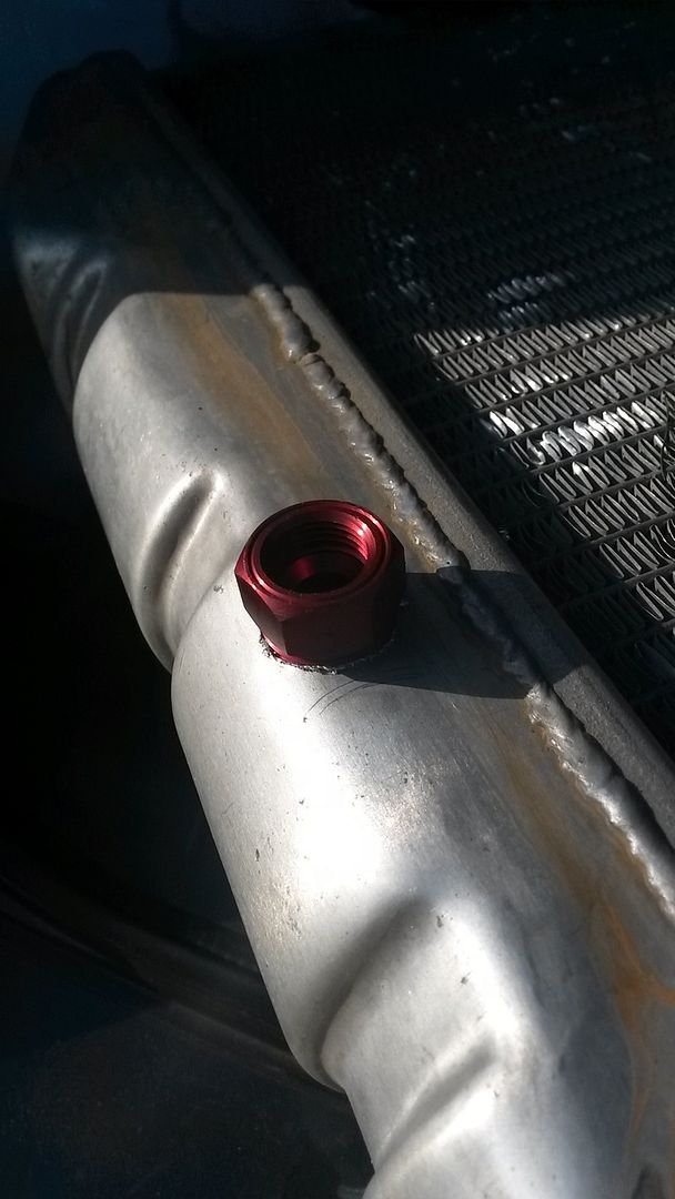

Coolant bung welded in =)

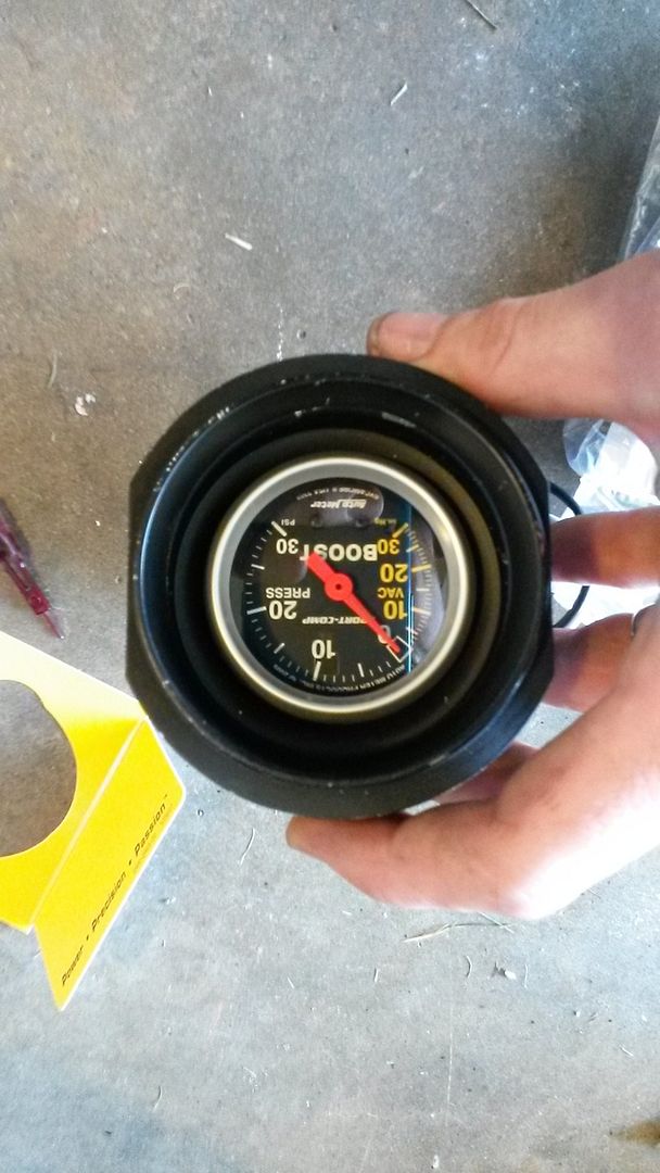

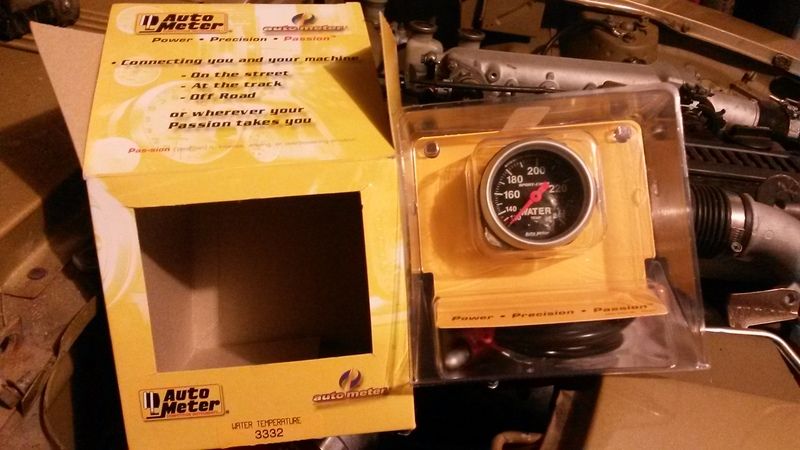

Run the boost gauge
