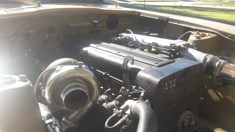

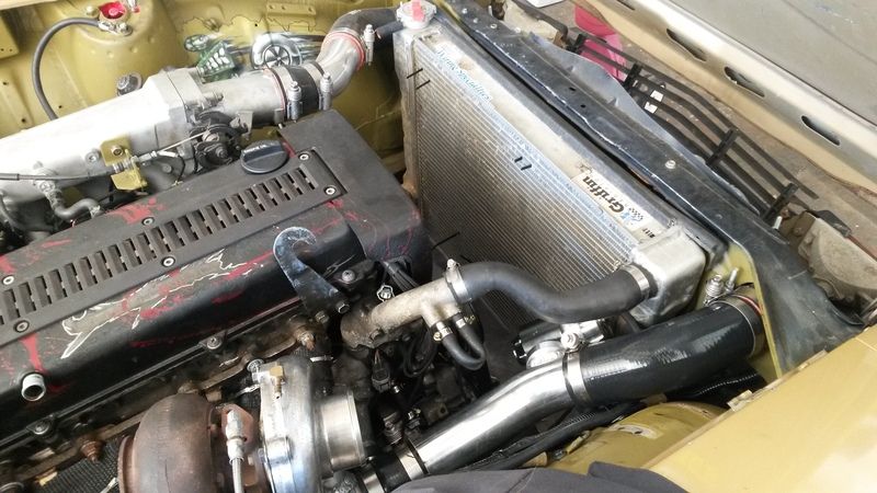

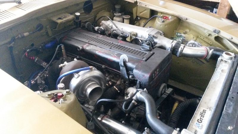

That is the ONLY MANIFOLD that will bolt on. All the rest I tried hit the waste gate in weird spots. This one barely clears the s30 subframe. It sets about 1/4 to 1/2 in away from subframe !
Well. Next will be running the oil return, making a cold pipe, and downpipe installation.

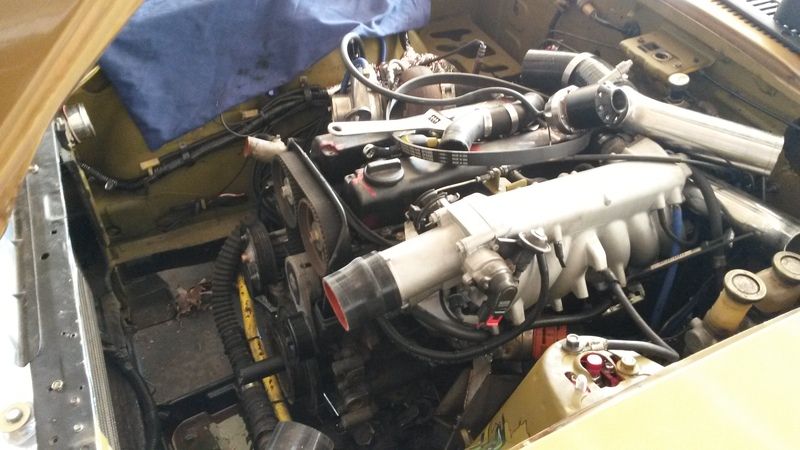

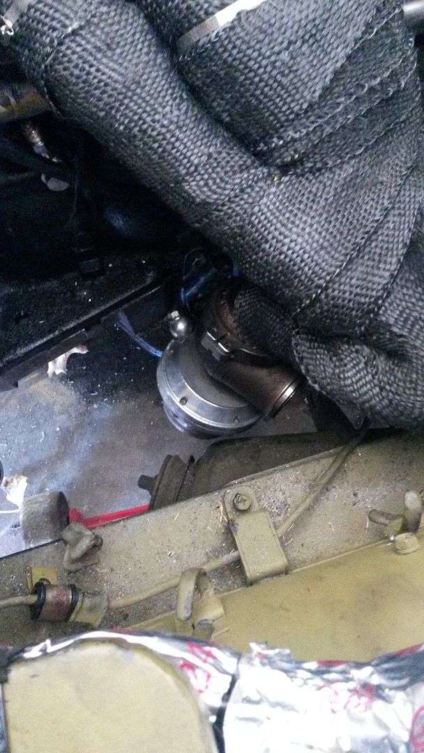

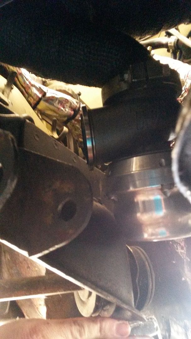

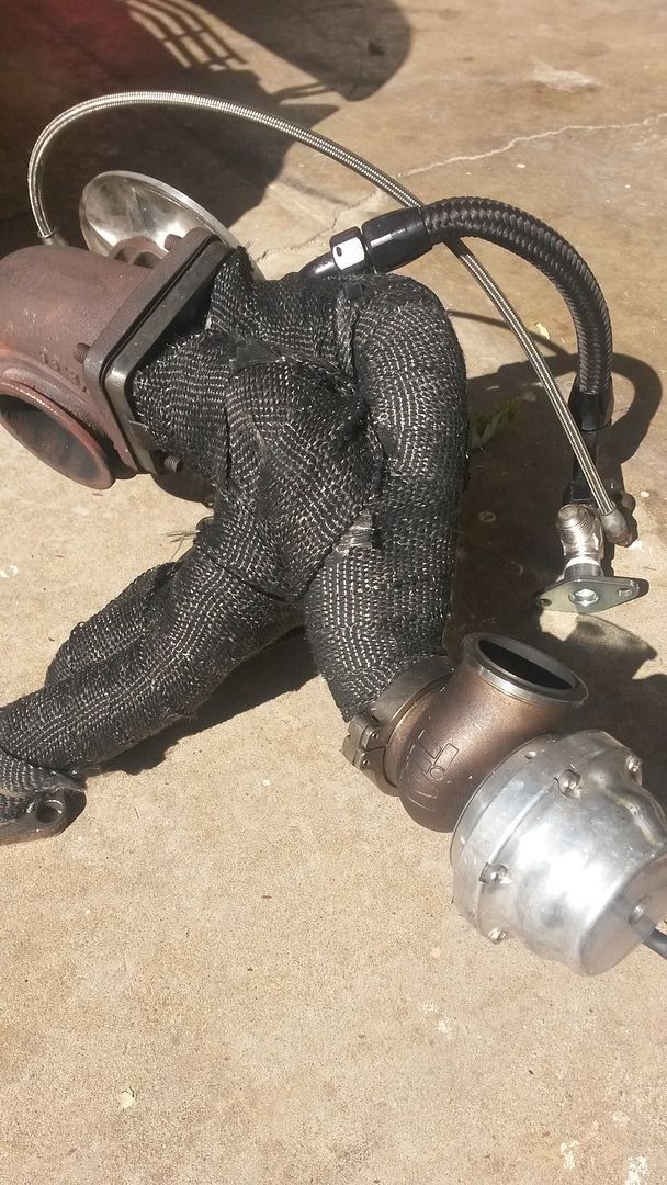

Here is my waste gate clearance. Still thinking of a way to run a dump pipe,and where to. Anyone doing 1jzgte, make sure to use this manifold! I tried 3 different manifold designs. Only know obe brand for sure. Driftmotion, doesn't clear with out modification.
As you see, you need the manifolds that have the waste gate pointing down, so you can gain access for the turbo down pipe to clear.

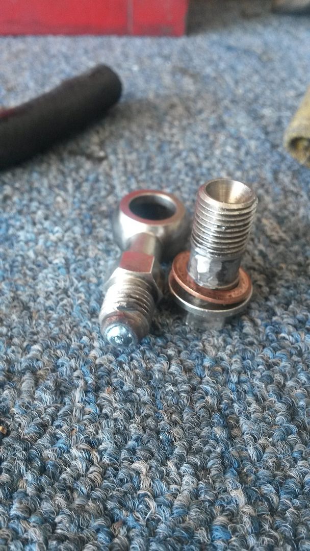

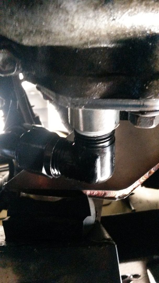

Then my engine mount is supper close to the drain fitting. Had to use a 1/2 to 10an 90degree to clear it!
It's all plumbed up and running, and still waiting on supply for the down pipe.
Also ordered wheel spacers to get a slightly better wheel fitment.

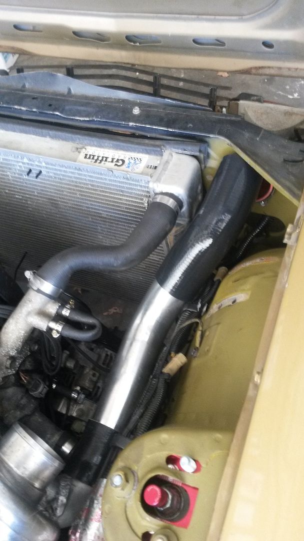

Here is the pipe I had a blow off valve welded on to...also added a 45 coupler. Soon after its running well, I am taking it in for 1 piece piping, with vband as couplers.

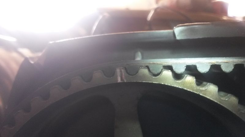

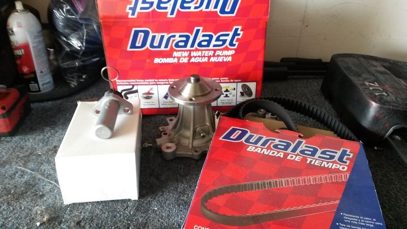

Tried to drive it to work...quickly got shut down by my water pump leaking! Arg! Lol. So I guess I will be doing timing belt, tensioner, and a 2jzgte water pump.

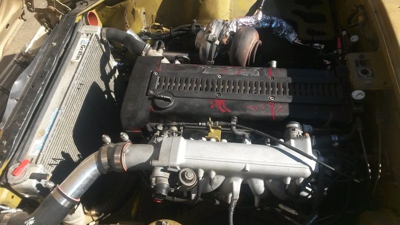

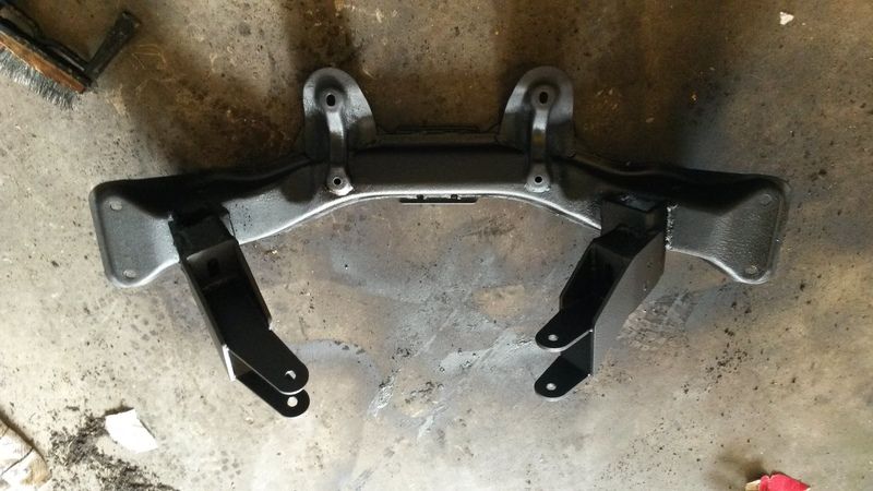

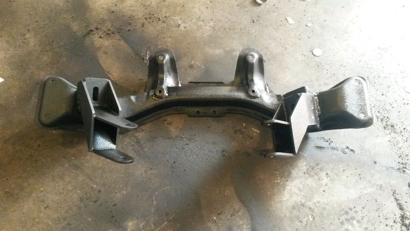

So after reading adjusting my engine mounts every week, today I bit the bullet and removed the front subframe with the engine still in =)
Got it out and welded up the cx racing engine mounts solid as a rock, and really coated the subframe.
This was kinda a pain in the ass, but I refuse to remove the 1jzgte again! Lol
