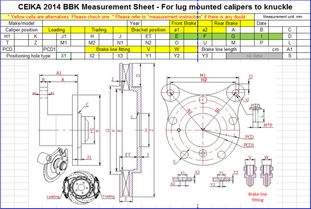

"Would you be able to fil up the measurement sheet and take the measurements of the hubs and drum parking plate bolt in place so we can designed the kit.
We can use a two holes caliper bracket that will bolt the caliper on the leading side of the rear wheel and it looks likes they will be plenty of clearance on this side ( opposite side of the shock) and the rotor wheel in stole on the actual hubs in place of the drums. You will have to choose by yourself the offset of the disc that will be best (it is best to make it as close to the inside as possible to give best wheel clearance) It will depend on the surface of the parking plate bolt in flange if you want to have the calipers brackets bolt in from the back or for the front. You can then work out the offset of the futurs rotors to be as close as possible to the caliper brackets or any other parts sticking out further.
About the discount we can do different types of discount it’s depend of your order. For example for coilovers kits, ten kits with the same specs or nearly the same is enough to do a discounted rate if it’s less we can offer some options like camber plates for example.
Or for the big brake kit from 2 or 5 kits we will be able to do a bigger discount depending the options and sizes you will choose.
I attached you the measurement sheet.
Waiting for your answer, feel free to contact us if you have any further questions.
Best regards.
Gauthier Milharo – CEIKA team"
So it looks to me like the coilovers will not be a true bolt on unit, and with the prices being similar to the BC Coils posted in another thread it's probably best to stick with something of a known good quality.
Their brakes are pre built kit, but they do have different colors and sizes available for a pretty good price, and appear to be able to create the necessary brackets to adapt their kits to the mounting brackets of the Z, so they might be a good option for brakes, especially if we organize a group buy. Their brake kits range from 4 pot kits to 6 and 8 pot kits with different caliper sizes and thicknesses to choose from. I have attached their measurement sheet for you guys to take a look at as well.
