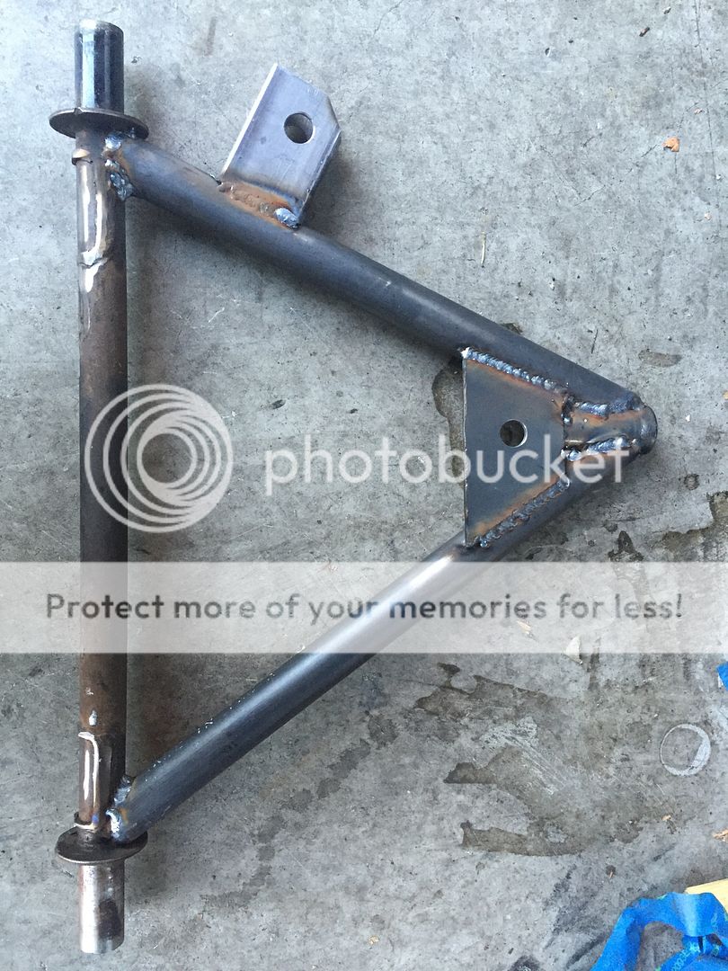

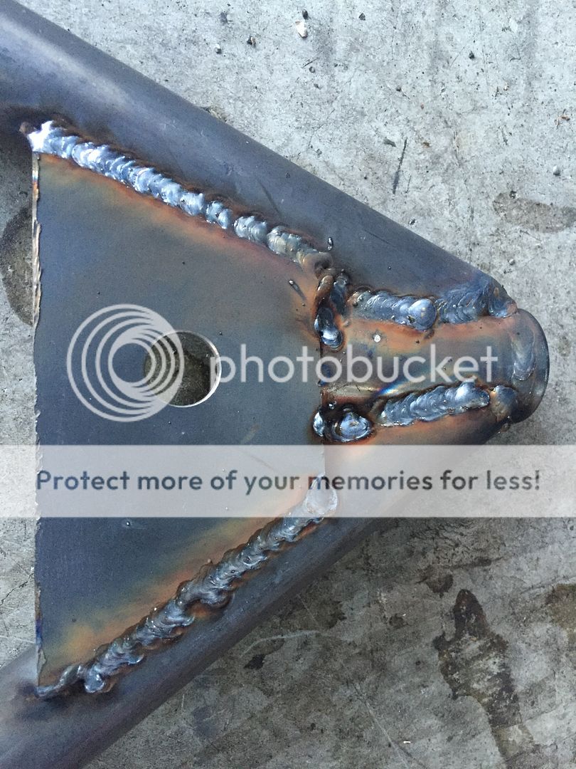

Welded as hot as my welder would go, penetration seems good. One of the arms is not quite inline with the original arm, slightly off in the plane. Might have to remake that arm at another point in time. Seems the rod end tube is still perpendicular to the mounting arm so I don't think the function will be affected.

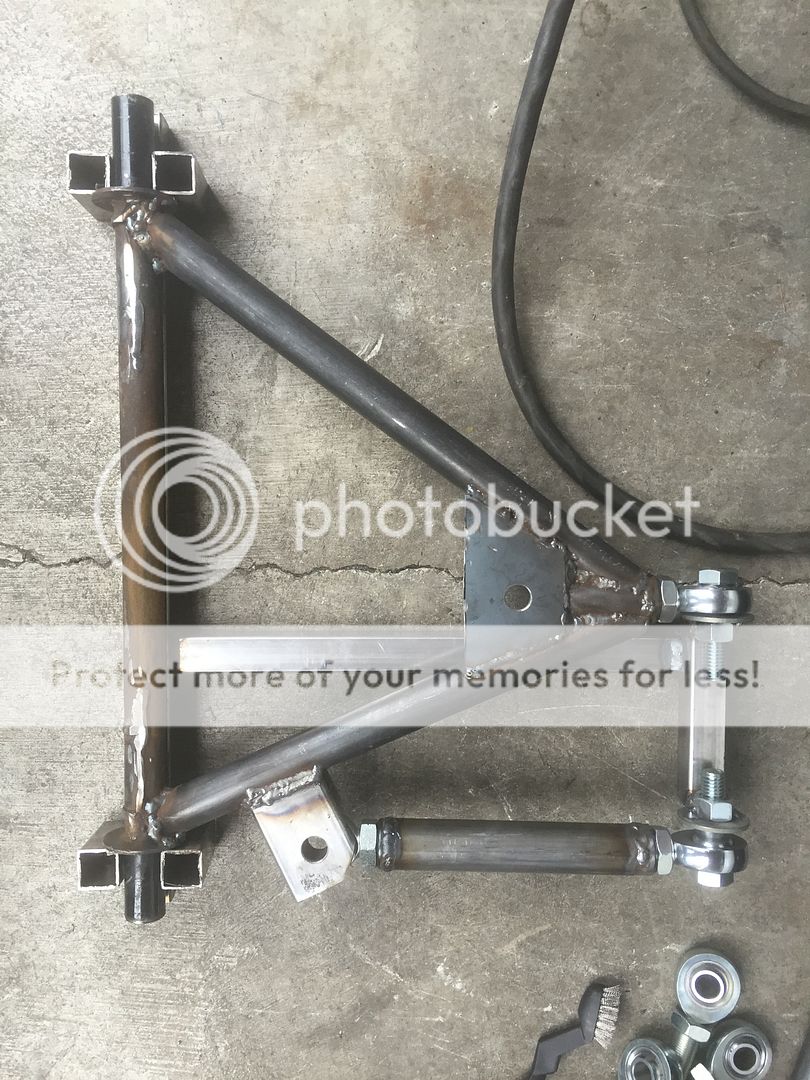

Coilovers arrived, I think I'm going to get those welded to the struts before moving onto the next arm. Still need to make the toe link arm turn buckle. LH threaded portion is done, just need to add the RH tube adapter after cutting to length.

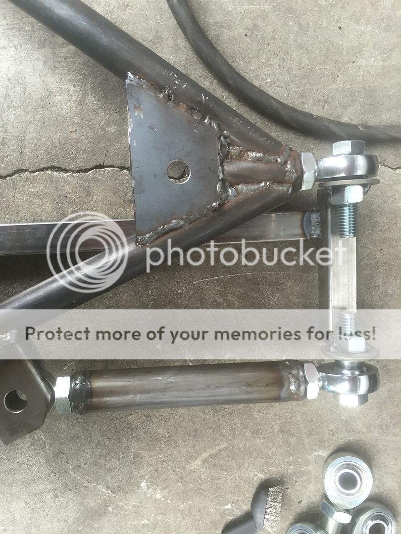

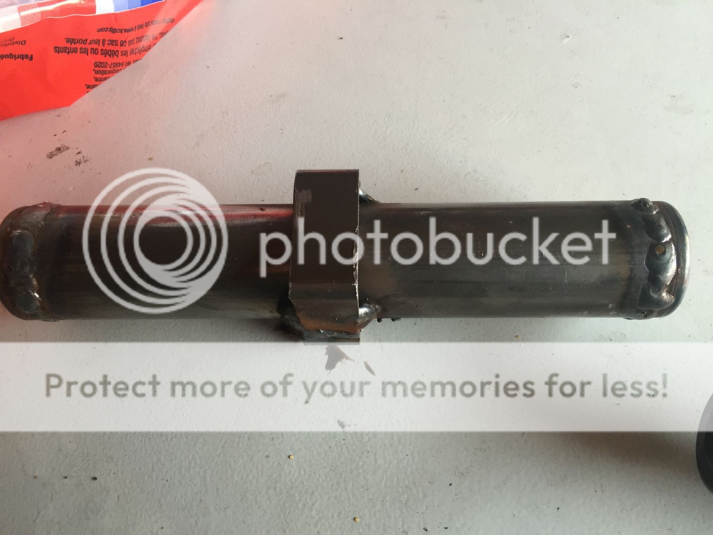

I'm making up a new set of rear adjustable LCAs and the length of my toe link was too short to make from two rod ends and a length of right hand/left hand threaded tubing so I made a "double adjuster" sleeve and coupled the two rod ends together. I think it's about the shortest non-removable adjustable link you can make (at least I think it is).

Jon, yes, I am doing the toe link in the front. The last ones I made had the link in the back and I've never had any issues but I agree with your opinion to mount it as close as possible to being under the lower strut mount, which is toward the front.
74_5.0L_Z, I really couldn't see anything on the Midwest control site that looked like mine. Mine are based on the ones that TTT uses on their arms but I needed my own special thread sizes on the adjuster, 3/4-16 on the outside and 1/2-20 on the inside, one right hand and the other left hand.

Some questions as it is my first time mounting up rod ends.
I seem to have thought somewhat ahead and ordered 4 spacers. I did not leave much room in the forward inner end (maybe enough for a washer or two), but would it be better to use the rod end spacer in the front as well as the rear (rod end spacer is being used in the rear? It would move the strut assembly back about a 3/16 of an inch maybe less. The toe link arm can be lengthened and swivel out.
On the outer ends, given the small face of the bearing, should I use a washer? Or would it be better to just put the bolt head and the nut directly onto the bearing to allow for a little more movement?
Also I imagine it would be advisable to use some sort of mechanism to get a good grip on the toe link turn buckle. Would it be better to just weld a flat piece on two sides? Or should I shave a bit of a flat onto the two sides? Personally leaning towards welding flats compared to grinding out flats.

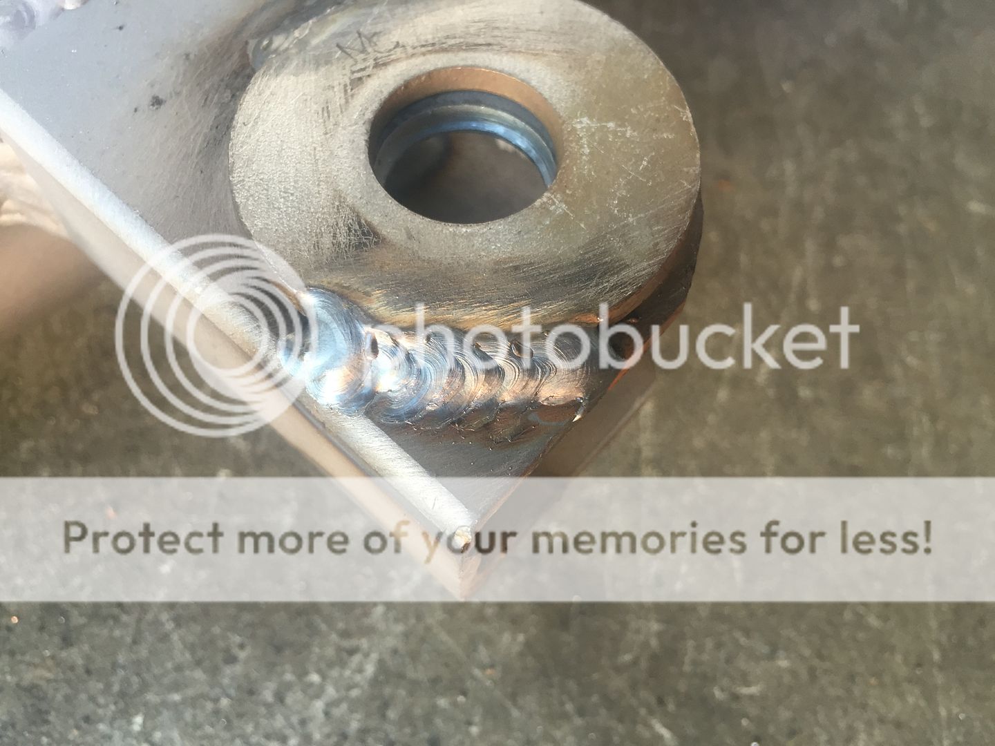

I welded on washers to the toe link bracket so it just adds a bit of thickness to the tear point.
