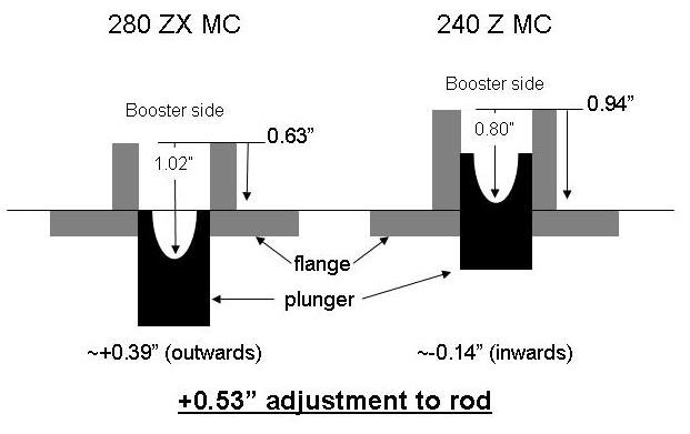

So I have very thoroughly researched this before posting here and I hope I don't catch any heat for this.  I understand for the 15/16 master cylinder conversion onto my 1972 240z you are normally going to lengthen the pushrod that actuates the master so that it can reach and do its job.  Well I bought this cylinder from Oriellys and it had no markings whatsoever on it.  No Nabco or 15/16 forged on. I saw on the listing for it that it had a .9375 ratio 15/16=.9375.  It did have the brake ports in the same position as the original and bolted on great.  I am having issues building brake pressure and this may be a possible reason.  The back part of the 15/16 master cylinder where the pushrod pushes is actually much more shallow than the same part of the 7/8.  This would mean I have to shorten my pushrod instead of lengthening it like EVERY single person that I have come across and read about.  Is this normal and I have just been confused the whole time or is this abnormal for a 15/16 master and I should try another one?  This may be the reason I can't build any pressure in the lines because this cylinder is wrong.  Any input would be appreciated!!

See pictures.

I have seen the pictures you posted here in an older thread and basically think of a third master cylinder, the one on the left for the zx was 1.02 inches, then the one for the 240z was .8 inches, now imagine mine being .5 inches.  I did the on car bleed where you crack the bleeders and let the fluid go back into the master quite a few times and saw zero air bubbles after the first bleed. Same goes for all brakes around the car, I am getting a syringe for that method and also another master from a different supplier to make sure what I have is what I need.  I just have never heard of anyone getting one and it ends up being much shallower instead of deeper like your picture shows.. would a poorly adjusted pushrod make for a soft pedal as well?  I adjusted the pushrod so I could just barely install the master without feeling any resistance of the pushrod.

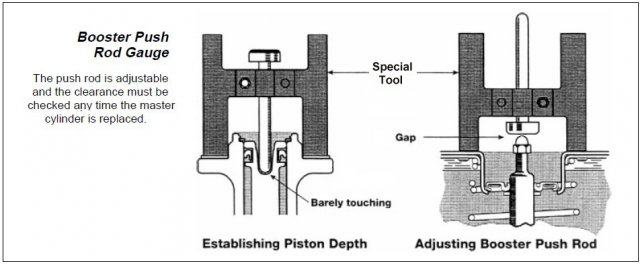

As I recall, the starting point for my 280ZX MC push rod adjustment was about 13mm  and for my Wilwood one inch MC it was about 14mm - 15mm.

I took this picture from a write up here done by z car nut and could this be my pressure problem?
