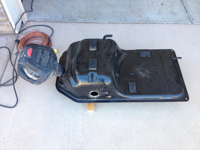

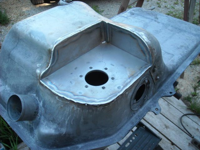

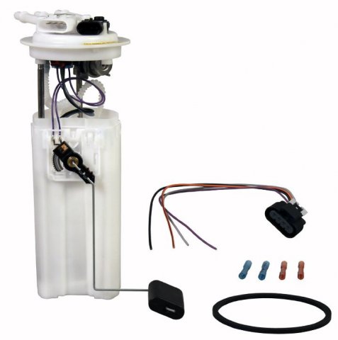

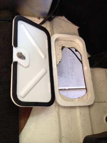

I just finished modifying my tank to accept an Airtex 99-02 F-body fuel pump module. Started with using my shop-vac to blow all the vapors out :)

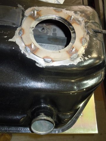

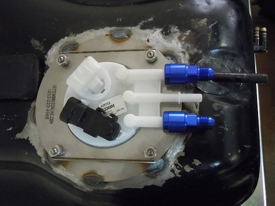

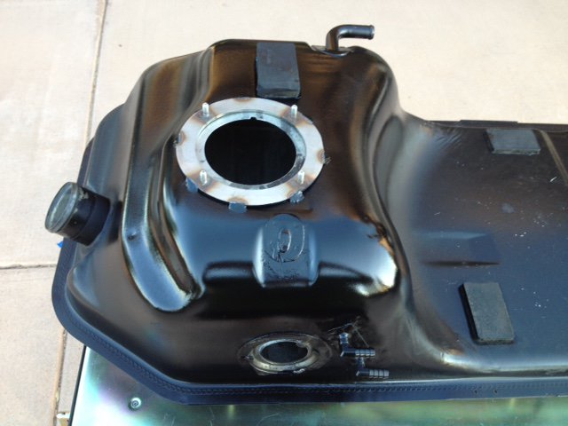

Then cut a hole in the top and welded on the VetteWorks retaining ring.

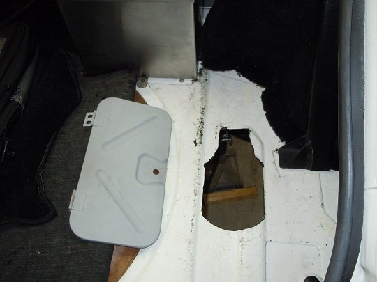

Then did a test fit of the module in the tank and set the tank in place to locate where to cut the hole in the hatch floor.

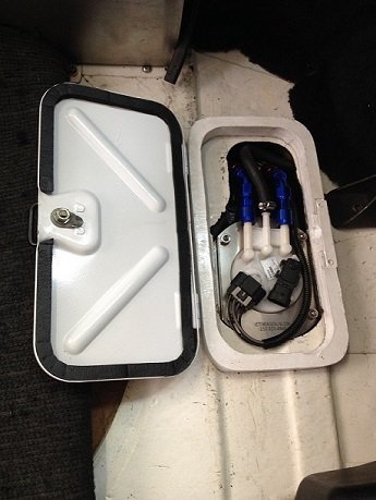

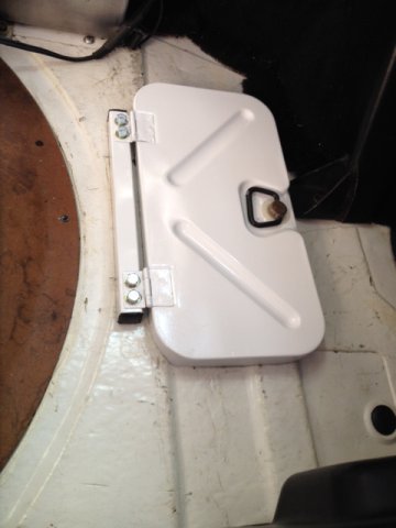

A friend donated a storage bin lid that I refinished to cover the hole. But I needed to build a base to accommodate the increased height of the tank + module + plumbing + wiring. Some 3/4" plywood, pieces of Home Depot paint stir stick and piece of aluminum angle  did the trick. I think it turned out pretty good!
