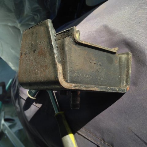

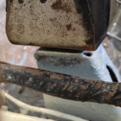

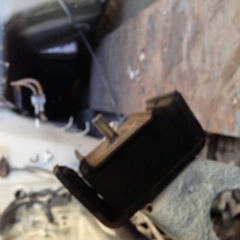

I'm glad i stumbled upon this, I am about to mount the rb20det in my 71 240z with the stock rb20det mounts and I kind of pre mounted the mount in the z and 'm trying to figure out do I need to "slot" the mount? Or just drop it in as is? Here are some pics. Maybe this can help the original PO'S question also
Did you get the mounts on the correct side of the engine.
Even with the L-Series in there, if you swap the motor mounts side to side, the engine sits upright and the hood will not close.
