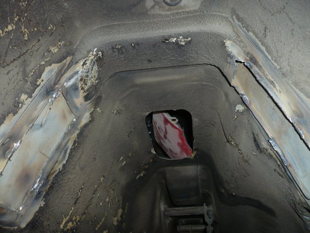

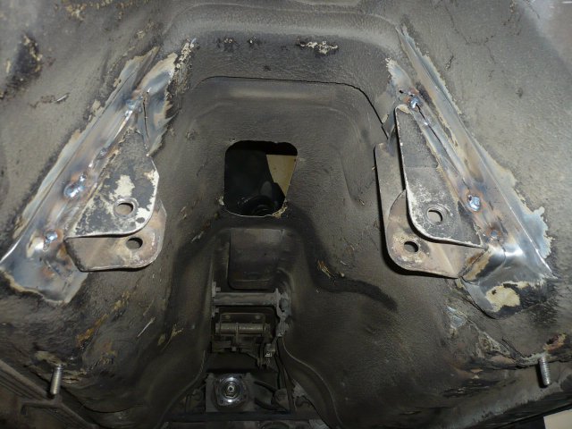

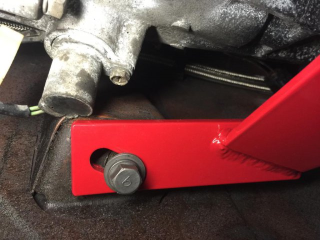

Thanks for the info ZT-R.  I've been through 15 pages of your build blog and can't seee any pics of the mods you did to the tranny mount.  Can you pount me in the right direction?  Do you mean the McKinney mount bent or do you mean the mount inside the transmission tunnel bent?
Also, do you know what the correct inclination of the RB should be?
Thanks!
I don't think i have any pictures of it. The mickenny didn't bend but the leverage put on the stock mounting bolts bent the mounting locations. i took some rectangle tubing and came off my frame rails and went directly in line with the trans mounting bolt rather than what mckinley did. ( i understand why they did it trying to make a bolt on solution) but my r34 gtst trans is really heavy. probably would be fine with a rb20 trans.

Exlifesaver, I left the speed sender in place but notched the mount in order to clear it.  You can see it in this short YouTube video I made to explain what I did.
When I next take the engine/transmission out, I'll weld in some plate to tidy it up, then I'll also add some bracing around the mount in the tunnel.
I've looked through so many build threads I can't remember which is which but I think ZT-R one did the notching, with no additional bracing on his build and it was OK?  Maybe look through his build thread.
