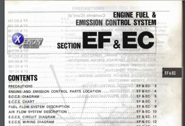

You're going to have problems if you can't generate the energy for a couple of clicks.  Of course, this may be the typical "life from a phone" problem.  6 or a half dozen.  What's worse?
Don't get mad, I'm here for entertainment.
Share this post
Sorry newzed, i've got lost since that image doesnt explain anything to what im looking for.
09 Feb 2016 - 08:53 AM, said:
Now, im in the processing of wiring between the engine and the z31 ecu. I did a research and have no luck of finding a good schematic for this set up. I have found an ecu diagram for a 240sx but not for the z31 n/a auto trans.
The ECU is part of the ECCS.
C'mon, admit it - you're on a phone and the EFEC chapter is too big to open on it.  It's all there, with labels, wire colors, all that you need.  So easy that this thread is just getting weird.  Open up the EFEC chapter in the link I provided and go to page 12.  Actually page 11 is useful also.
Seems to fit the words you wrote.  Good luck.
