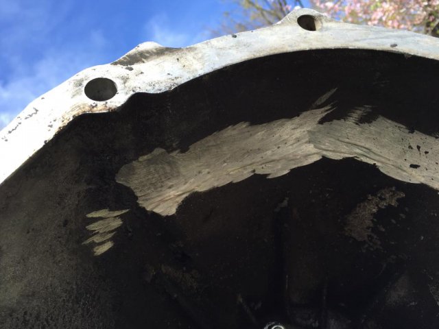

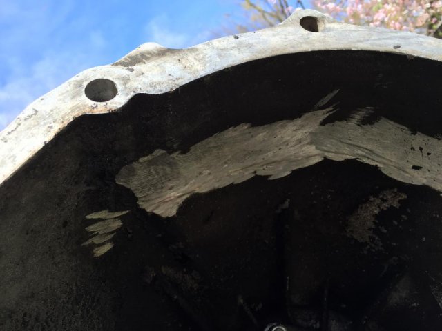

Ok, working on a 240z with a L28ET swap. We did a XTD 15lb RB20/RB25 flywheel with a 250mm surface, we also sourced a XTD 350z clutch.
We are also using a close ratio FS571W-B 5 speed from a 280z.
I've read a few different threads where people have done this, but no definitive answers as to if it is direct bolt in, or any lingering modifications had to be done, but here is what our experience was.
Not sure if name brands like Exedy or Clutch Masters would fit different, but I've been using Gripforce, F1 Racing, XTD clutches for years with ZERO issues, I think a lot of the negativity stems from improper installation.

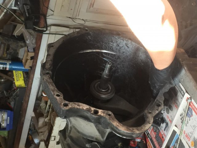

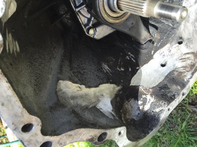

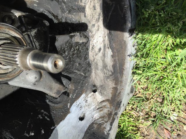

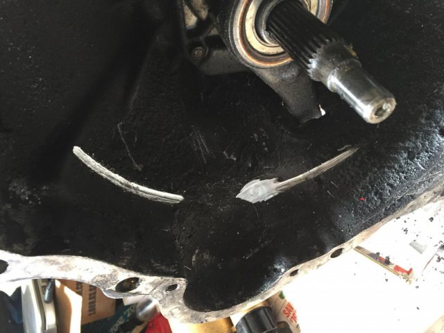

Anywho, we did have to grind away some material on the inside of the bell housing.
The transmission bolts up, slides in and everything, you wouldn't think there would be any issues at all, it bottomed out against the dowel pins in the block.
When we went to start it the first time, the non-gear reduction starter just clicked, like the motor was locked. It was faster for us to swap to a spare gear reduction starter, rather than remove the radiator and fans to get access to the crank bolt, It's a tight fit on this non-stock build lol.
So with the gear reduction starter it cranked, but fairly slow. So we pulled the starter and saw some fresh metal shavings.

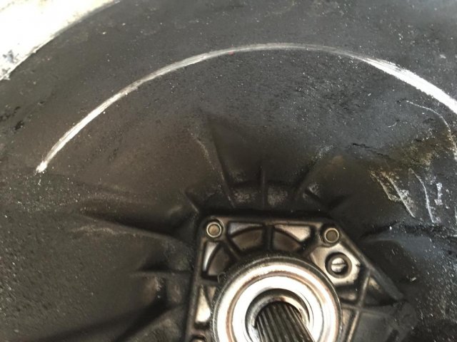

Pictures will be as follows, nice clutch cover line around the majority of the perimeter of the bell housing.
Not sure if because it's an earlier 5 speed that the bell housing casting was a little tighter than the later ZX trannies, or if the clutch cover was a little out of tolerance, but it rubbed enough to slow the cranking down. So we "clearanced" the bell housing to allow the clutch to move freely and now it cranks fine and works like a charm.
I would definitely recommend this upgrade, because this flywheel is ALOT cheaper than the L28 fidanza flywheel, and you get an extra 10mm of surface area, PLUS you get the clamping force of the 350z clutch, this thing will hold more power than this engine will ever see.
Definitely not for the feint of heart, but a 4" angle grinder did the trick in about 5 minutes to grind about 1-2mm of material out of the way to clear the clutch cover.

Yea, it's not much material that has to come off, the best way to mark it would be bolt the transmission up and turn it over a couple of revolutions to "bed" the bell housing, then pull it back off and grind in the marked areas.
I bought a $20 electric angle grinder from harbor freight, did the trick in about 5 minutes lol.
The clutch is a stage 2 and it is definitely a stiffer pedal feel than a stage 2 280zx turbo clutch. But i'm hoping once it gets broken in and used a little bit it will lighten up. it's not unbearable by any means. It still has the damper springs in the clutch plate so it won't be on/off feel like a stage 4 solid clutch plate.
I've driven cable clutches with a stage 4 and you wanna talk about a leg and ankle workout lol.
It's a shame you didn't measure that mark from the bell housing flange so we could have a reference
If you look at the picture where the clutch slave bolts are in the bell housing, you can use that for a reference, grind down 1/2" to 3/4" on each side of the bolt, and work around. Or just bolt the trans up with 2 bolts, bolt your starter up and crank the engine a couple of times, remove trans again and see where it hit.
I'm running a FS571W-C with a "B" bell housing, so when I do this conversion with my motor build, i'll actually measure where to grind down. We are on a time crunch trying to get the car ready for Hot Import Nights, so we are moving as fast as we can.
