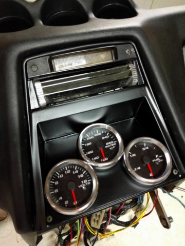

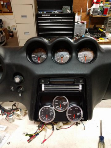

It's an 3D printed ABS panel made for SpeedHut 2-5/8 revolution gauges (as shown).  I took lots of measurements, modeled it up, printed it at a local print shop then cut out a matching hole in the stock panel.  It'll eventually get bonded in place and painted when I'm happy with it.  It probably needs tweaking again before I make it permanent.  I made another panel to adapt the Vintage Air controls to the console opening where the choke light, antenna and rear defrost used to be - none of which work in my car anyway.
