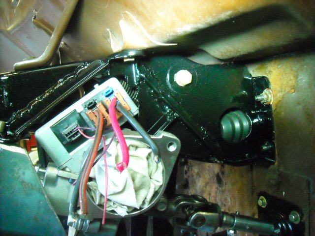

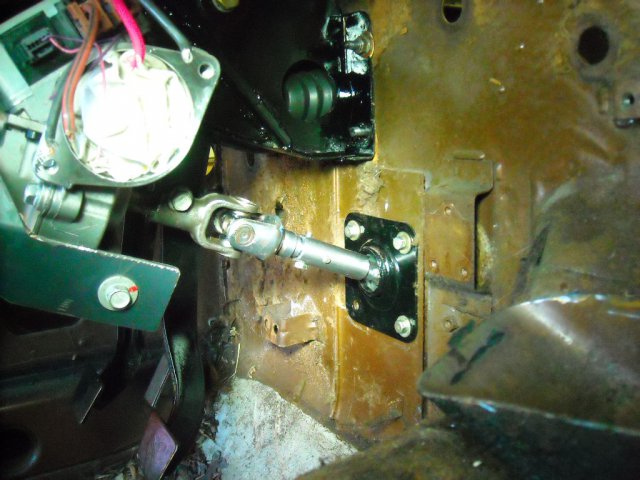

I have almost completed the Saturn Vue electric assist steering in my 240Z, just waiting on the wiring kit from ebay Bruno, I had to cut and modify the steering shaft/pedal box to fit it in and then reinforce the box to stiffen it back up, the pics will explain it better then me. The unit weighs 14lbs and then add a couple more for bracing and a u joint, so far I have $144.00 in to it, looking forward to trying it out in parking maneuvers.

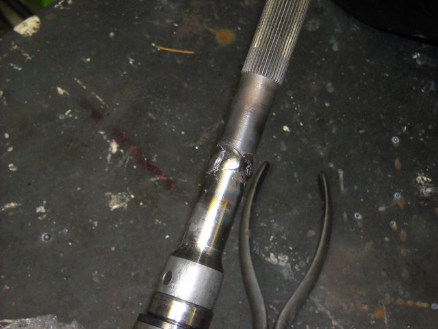

The 1st pic is what was cut out of the steering/pedal box, 2nd is the bracing around the hole that I added, while the paint was off I also added some key welds where previously there was only spot welds. There is a middle shaft on the 240's, I used the splined section of that to weld onto the Saturn input shaft, the Saturn output shaft is coupled with a simple sleeve and 4 grade 8 bolts to the cut off end of the stock middle steering shaft. Once you get down to your steering/pedal box come back and have a look at the pics in post #27 again, it will make a lot more sense.

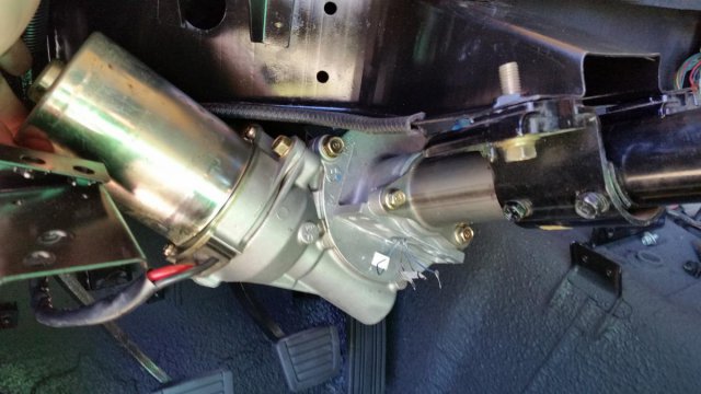

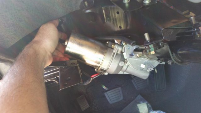

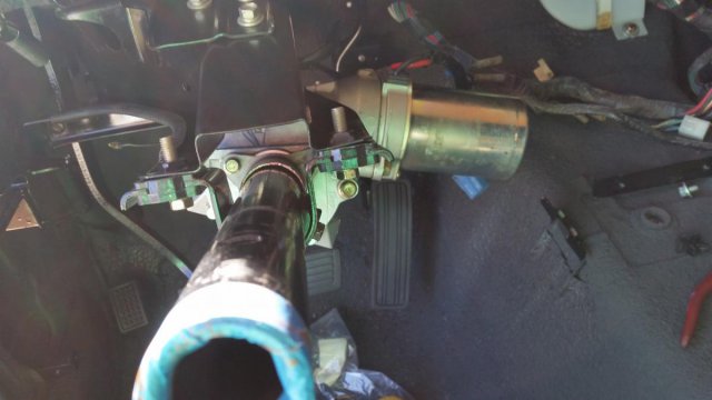

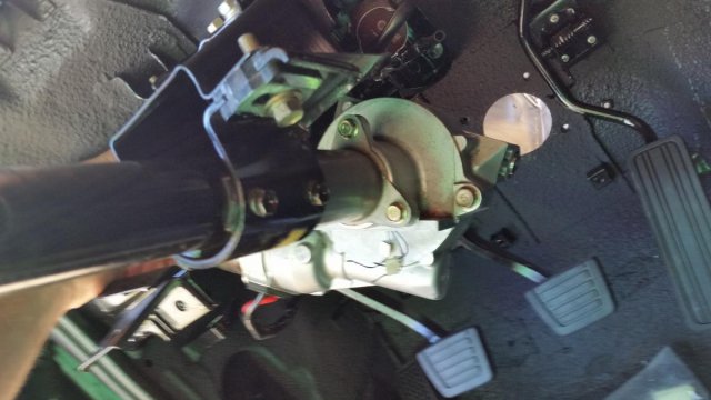

I took my Saturn and Datsun columns apart last night. On a 78 it looks like the motor will barely fit clocked at the 10-11 o'clock position. Does anyone know if removing the steering coupler like the ez power steering kit does will cause any issues? Woodward sells the Datsun u joints and splined connectors, so you could use a DD collapsible shaft on the saturn end and put a DD-Datsun spline shaft to connect to the steeering rod under the hood.

This is the plan I came up with. I really want to keep the collspsibility, and don't want to take out the dash to weld bracing into the column support. I will attach the upper section of the Datsun column to the top of the motor with the 3 bolts it comes with.I will make a 1/16 or 1/8 plate to the pattern on the existing upper Saturn tube and put a collar on it the Datsun tube can slide into and weld to. Use the Saturn spline piece to make a connector to go from Saturn to Datsun. Make a plate to bolt to the 2 bolts on the lower side of the motor and weld a square tube to it that a 17mm couple for the Saturn spline can fit into. Slide another square tube either into it or over it and weld that to the firewall plate. Between the column support and firewall plate, that should keep it from twisting. Use a DD collapsible shaft from the 17mm Saturn spline down to a u joint that's DD on one side and Datsun steering rod spline on the other. Does anyone know where I can buy square tube and they will test to see if they fit snugly inside of each other?

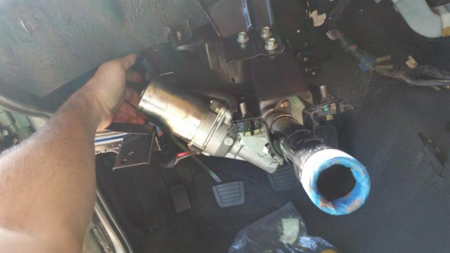

We had 2 78 280, one complete and 1 with bare interior. We did a few mockups, looks like motor may be able to go towards right with a small notch in column support and without factory AC. I have vintage air and my ac blower is in the way. To the left and up it will just fit with just about zero wiggle room. Either way looks very tight but doable.

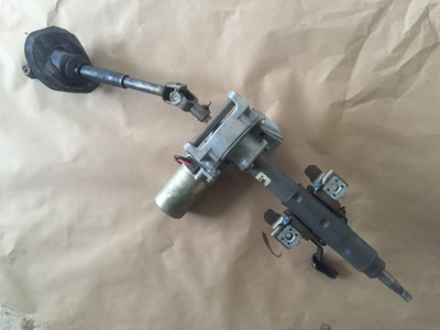

After getting it in and mocked up, the plan is to use the lower shaft from the Vue which is collapsible. Will do like Z power steering and just put a bearing at the firewall for support. Just needs a DD male fitting to Female Datsun spline to replace the round steering coupler. The motor will be supporter by the upper column, plus a small L bracket from one of the mounting holes of the steering unit to the column support. Should only have to drill 1 bolt hole in the column.

Looks like a well thought out plan. I plan to do the same and will be following this closely. Luckily I have access to a machine shop where I can have the 3-bolt plate/tube nicely made. I'm grabbing the entire shaft assembly from an equinox shortly. Will even see what the equinox tube looks like to be adapted to the Datsun one if I can get it out of the equinox. Could always bring a sawzall :P.

You have to take the bolt entirely out of the DD fitting where it connects to the saturn steering and it slides right off. That looks like the vue column.

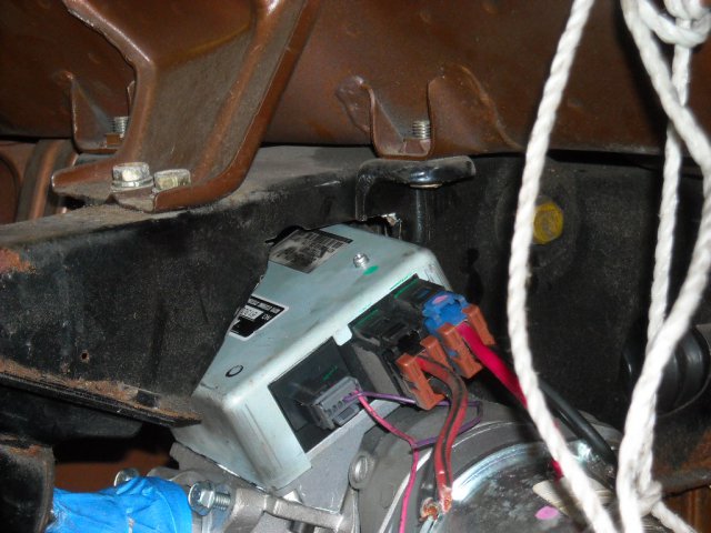

If you pull the Saturn wiring all the way out, it comes with a fuse inline, I think 80 amp. I will try to reuse that wiring if possible. I am going to remote the control box. http://forums.vintage-mustang.com/mod-custom-forum/787114-best-200-mod-ever-eps-70.html
This is where I got a lot of info from. One guy was talking about running the power feed through a relay in case something ever were to malfunction, he could switch it off.

The Woodward u joint fits the datsun rack, and has a DD on the other side of the joint. That means you can use the lower Saturn shaft as is. You will just have to separate it to pass through a bearing with a 1 1/8 ID at the firewall. A 3/4 DD steering g rod fits in both the Woodward u joint and Saturn u joint. We need to try to find a bearing with set screws to attach to a pipe welded to a plate on the firewall for the sa turn steering shaft to pass through. Anyone know where I can get a bearing that's 2 1/8 OD, 1 1/8 ID WITH set screws to be able to hold it in place?

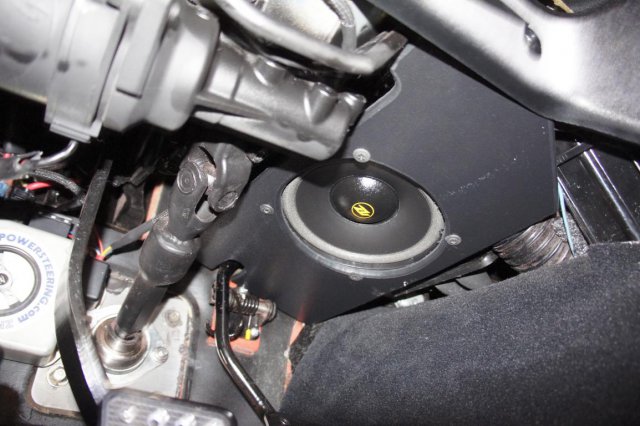

I installed the Z Power Steering kit in my '72 240Z last year.  Had some space limitations, but managed to overcome them with enough patience, trial-and-error, custom made brackets, etc.  Steering effort below 40 MPH is excellent - very easy to maneuver for parking, etc.  My issue concerns higher-speed handling and "feel".  No matter what level of "boost" is dialed into the system, my car feels very "light" in the front end, and lots of minute back and forth corrections are needed to keep the car on track.  It almost feels as though there is some looseness, or rotational "play" in the steering column now, making precise corrections very difficult.  There is one "sleeve connection" between a solid and hollow D-shaft that is not secured by any set screws, and I notice some rotational "play" originates there.
When steered into a turn, the wheel just maintains the turned position, with no self-centering effect coming out of the turn.  While the kit reduces steering effort dramatically, it also seems to impart some friction, or vague resistance, to the steering effort, that is difficult to describe.  I'm trying to figure out if this is due to my personal installation, or if it is simply an inherent characteristic of the electric motor of the kit itself.  Noteworthy is the fact that the motor unit itself wants to turn strongly in the opposite direction to the steering wheel, making it important to somehow firmly bracket the motor housing under the dash.  The kit manufacturers have tried to help resolve these issues, but we are not there yet.  For me, the "jury is still out" on this system, as I feel I may have traded some steering feel and precision for the reduced effort I wanted.  Still hoping to find a solution, because the lowered steering effort at slow speed literally transforms the car.  I'd really like to hear from others who have installed this particular system on their early Z's.
