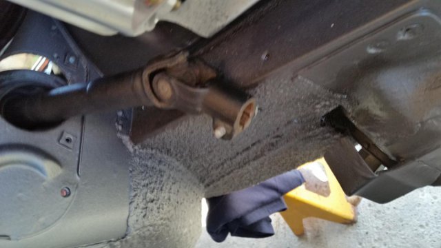

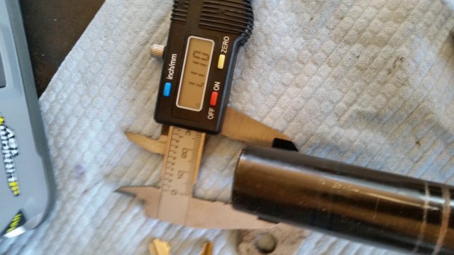

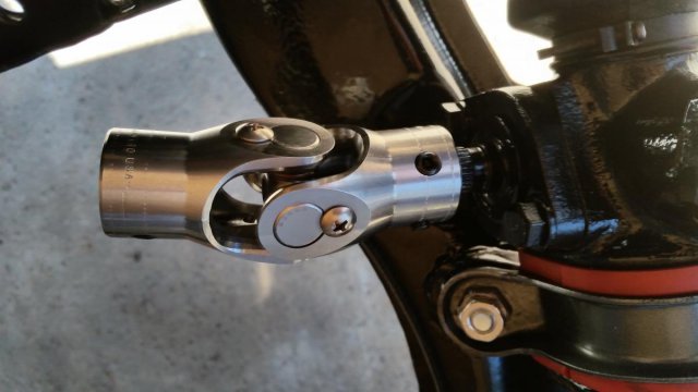

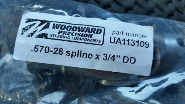

The Woodward u joint fits the datsun rack, and has a DD on the other side of the joint. That means you can use the lower Saturn shaft as is. You will just have to separate it to pass through a bearing with a 1 1/8 ID at the firewall. A 3/4 DD steering g rod fits in both the Woodward u joint and Saturn u joint. We need to try to find a bearing with set screws to attach to a pipe welded to a plate on the firewall for the sa turn steering shaft to pass through. Anyone know where I can get a bearing that's 2 1/8 OD, 1 1/8 ID WITH set screws to be able to hold it in place?
Edited by socorob
  • 4 weeks later...
The Woodward u joint fits the datsun rack, and has a DD on the other side of the joint. That means you can use the lower Saturn shaft as it. You will just have to separate it to pass through a bearing with a 1 1/8 ID at the firewall. A 3/4 DD steering g rod fits in both the Woodward u joint and Saturn u joint. We need to try to find a bearing with set screws to attach to a pipe welded to a plate on the firewall for the sa turn steering shaft to pass through. Anyone know where I can get a bearing that's 2 1/8 OD, 1 1/8 ID WITH set screws to be able to hold it in place?
Not sure if you're still looking for a bearing or not, but I think this could work for you:
https://www.thebigbearingstore.com/1-1-8-four-bolt-flange-bearing-ucf206-18/
That one doesn't pivot. I just got the bruno controllers in the mail on Saturday. I have been too busy to work on this lately, but hopefully will be able to make some progress in the next week or so. There's a bearing in the bottom of the Z column that the Saturn shaft almost fits through. I may attempt to bore it out, probably needs to open up 1/16. Then I could use the stock bottom plate, as long as it lets it slide enough to collapse still.
