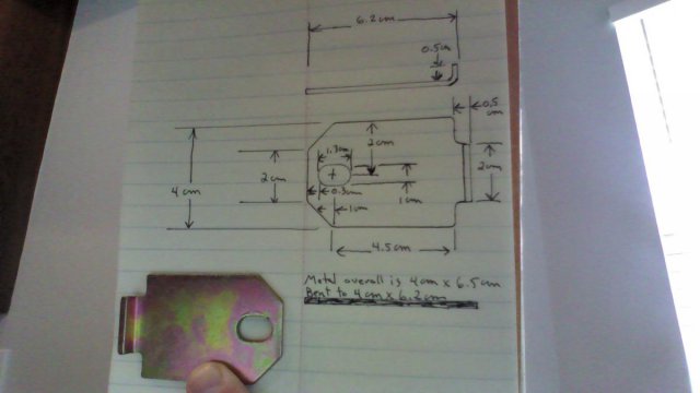

It was a little bit difficult finding these mounts, so when I got them, I measured them.
It would be so much cheaper to make them, but since I didn't have the measurements .....
Attached, please find the drawing and measurements. I hope it is clear enough, been almost 30 years since I did drafting, lol.
