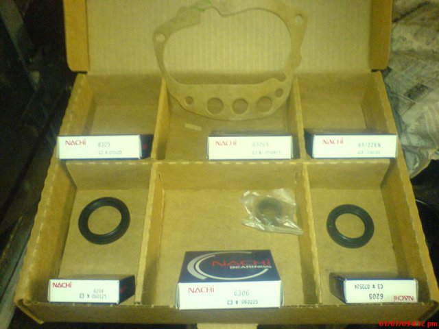

These are the guys I ordered my rebuild kit from, http://www.drivetrain.com/parts_catalog/manual_transmission_overhaul_kits/nissan_f5w71_overhaul_kit.html
It was a good quality kit but as New Zed says you might want to try some of the different oils first, they can make a big difference.
The guy I bought my 5 spd from said that it had to be rebuilt, so I rebuilt it but I found nothing that needed to be replaced. Bearings were good, so were the syncros.
