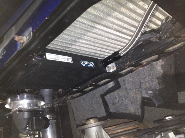

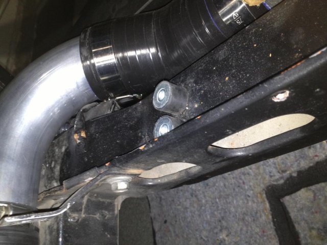

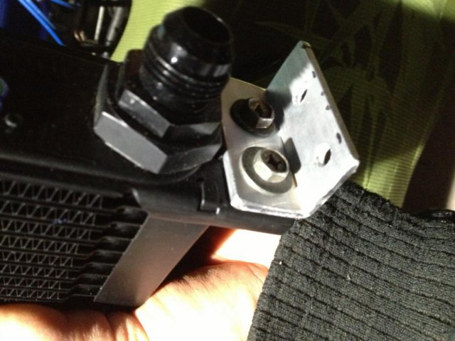

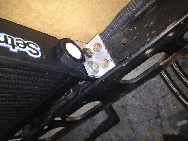

That's very interesting. Contrary to what I've read in several cooling articles in reputable articles in Race Car engineering, Circle Track racing and other Technical books. Those recommendations apply to racing cars though, where heat management is critical. Carroll Smith recommends to avoid mounting any auxilary cooler in front of the water radiator. That's relatively easy to design  in a Race car, but  not always practical in a passenger car.
Nice installation of the Setrab. I like how you've used rubber mounts to isolate the oil cooler from vibration. A critical point often over looked.
Share this post

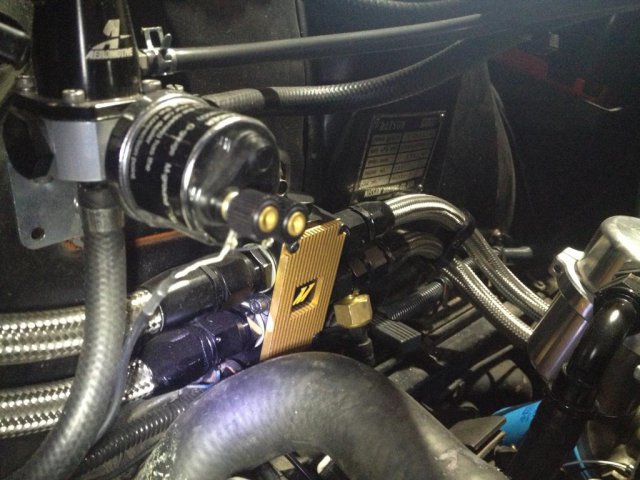

Some companies recommend different locations for their coolers. Mine is an 1"-2" in front of the rad. I can't get temps over 190 no matter how hard I try. I saw no increase in my water temp by adding the oil cooler so the location works, at least on our cars.
On a side note, I was experiencing oil pressure drop on tight corners. I was going to get an accusump but thought that the cooler oil will let the oil maintain its viscosity and it did. Now there is almost no pressure drop.
