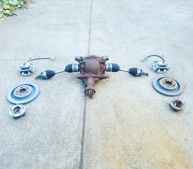

Putting in my order for this set-up has rejuvenated interest in my Z. This Super 8.8 swap is something I can actually afford. Better struts, serviceable diff, stronger axles, hubs, and companions, 5 lug swap, bigger brakes, all pretty much bolt on parts with minor fabrication. Thrifty shopping and planning will make this whole swap significantly less than a set of aftermarket R200 axles. Plus I can buy the replacement parts from local parts houses. I'm stoked! Thank you for following through with your word and actually bringing something to market. Who needs an obx fitted 3.36 R200? I'll have one available soon. 😜🤣🤣

Yes, I got a 3.31 iron housing (manual trans car) from LKQ. Prices at LKQ for the diffs alone are pretty cheap, they go from $220-$600. Mine has 67k miles on it and was advertised at $260. They charge more for those labeled "clutch type lsd", but as said above, that's what they all are aside from the torsen ones.
