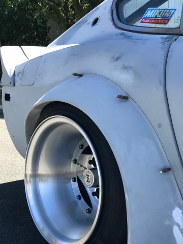

Hakone Motorsports 2 Posted February 9, 2018 Author Share Posted February 9, 2018 On 1/28/2018 at 10:17 PM, Ereschkigal said: Of the new ones: 1. second picture number 1 2. orange/grey (no. 4) What tool did you use for the models? We had someone do the design. He is on Instagram as “noguilt.” Quote Link to post Share on other sites

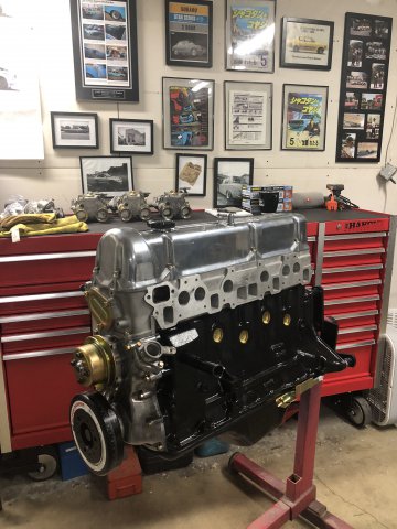

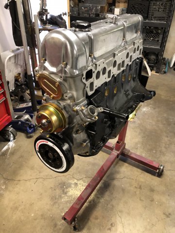

Hakone Motorsports 2 Posted February 9, 2018 Author Share Posted February 9, 2018 Over the weekend there was a bit of progress with assemblying the engine. More to follow, but progress pics are always fun. Bored .020 over Reground Camshaft Upgraded Valvetrain Resurfaced pads Upgraded Pulley Quote Link to post Share on other sites

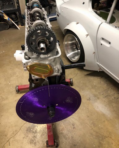

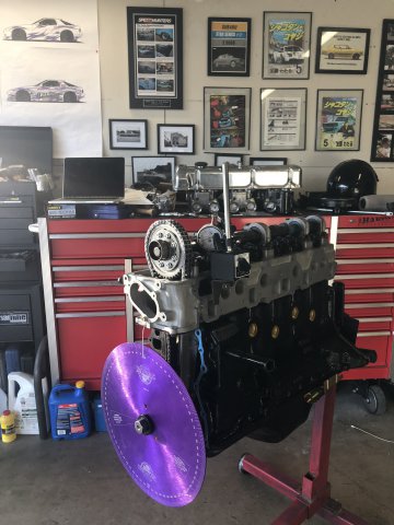

Hakone Motorsports 2 Posted February 27, 2018 Author Share Posted February 27, 2018 How many people have used a degree wheel on these L6 engines? I have found the only way to really ensure accuracy on the cam is to go off the valve retainer, preloading the dial indicator and recording the readings on the intake and exhaust opening and closing at .050. The online calculators will then help you walk one into the required centerlines from the cam card comparing cam lobes in relation to the crankshaft. This is the only way I have found to work due to the lobe profiles on the camshaft being different. Has anyone else found a better way? Quote Link to post Share on other sites
1969honda 2 Posted March 3, 2018 Share Posted March 3, 2018 You might get better answers on your degree wheel question in the Nissan L6 section. Progress is looking great, keep it up. Quote Link to post Share on other sites

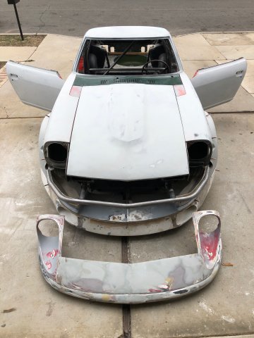

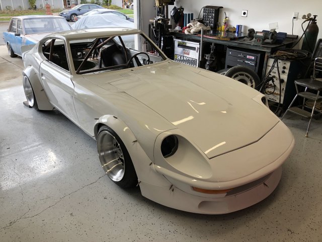

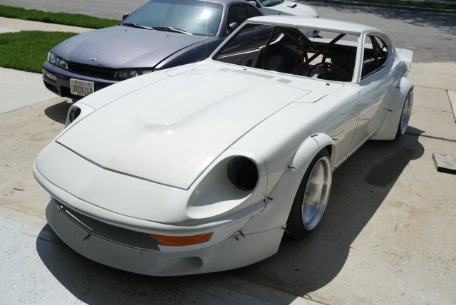

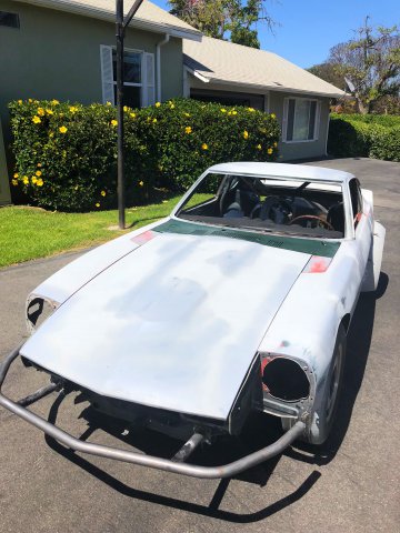

Hakone Motorsports 2 Posted March 9, 2018 Author Share Posted March 9, 2018 (edited) Did up a removable bash bar for the G nose and fit the lower half of the G nose to the bash bar. The corner lamp mounts were pretty far off so the light mounts were cut out, then fiber glass was layed over the tubing that was masked and further trimmed to fit the bar once curing started to take place. The wheels, seat and mock up dash was fitted and pushed down the street for some motivational progress shots. The roll cage is put on pause until I figure out what would look functional while keeping it from looking like a jungle gym. Edited March 9, 2018 by Hakone Motorsports Quote Link to post Share on other sites

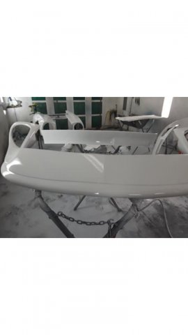

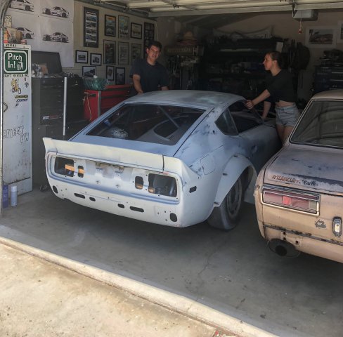

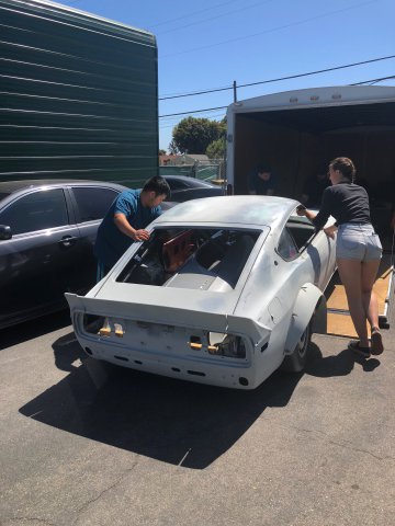

Hakone Motorsports 2 Posted June 17, 2018 Author Share Posted June 17, 2018 Currently overseas with my day job, but a couple friends ended up hauling the z car to the painters place for final body work and paint. Also, ended up finding an arita speed front lower spoiler and OEM G-Nose hood hinges here in Japan. Quote Link to post Share on other sites

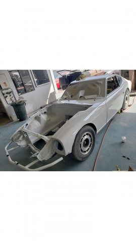

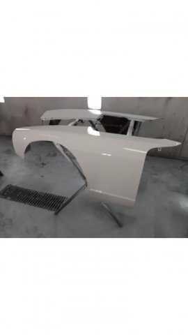

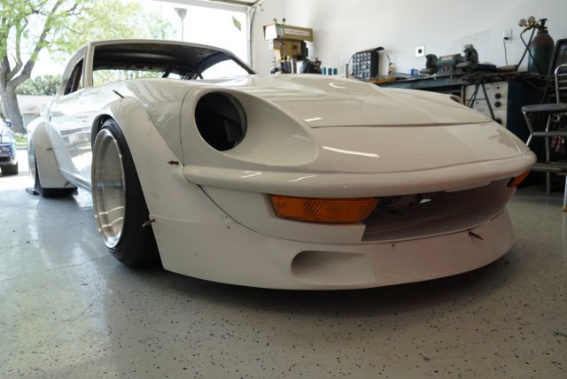

Hakone Motorsports 2 Posted September 29, 2018 Author Share Posted September 29, 2018 (edited) Little update to the build. Its at paint (RM_Collision on IG) currently getting the 904 Kilimanjaro White. Should look pretty neat with the flares and wheels. On a side note, anyone have any recommendations on where to get a windshield? Edited September 29, 2018 by Hakone Motorsports Quote Link to post Share on other sites
Jboogsthethug 3 Posted September 29, 2018 Share Posted September 29, 2018 8 hours ago, Hakone Motorsports said: Little update to the build. Its at paint (RM_Collision on IG) currently getting the 904 Kilimanjaro White. Should look pretty neat with the flares and wheels. On a side note, anyone have any recommendations on where to get a windshield 3 This looks awesome! I am jealous at how fast your car is coming to fruition! Also, digging how you threw the bash bar on behind the G Nose, spiffy! Quote Link to post Share on other sites

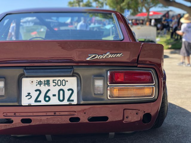

l2o8v0eZr 0 Posted October 1, 2018 Share Posted October 1, 2018 (edited) Love seeing the Okinawa license plates!! Here's mine that I had made for my Z.http://imgur.com/a/QkojVtN Edited October 1, 2018 by l2o8v0eZr Quote Link to post Share on other sites

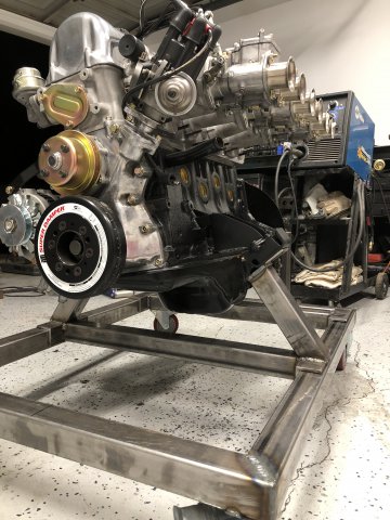

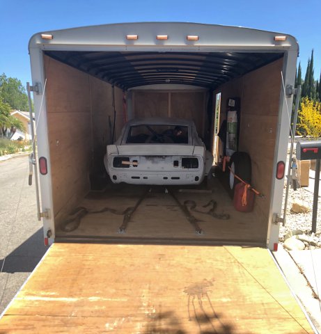

Hakone Motorsports 2 Posted May 6, 2019 Author Share Posted May 6, 2019 Been a while. I had to pull the car from the painter / body guy. Car turned out really bad. Like embarrassingly bad and even got scammed 2k in the process. Anyways, got the car back along with all of the parts and had my good friend Chumpot take care of all the glass work. Recently dropped it at the painter, west coast jones, in Rancho. Oh, and started building an engine test stand. Quote Link to post Share on other sites

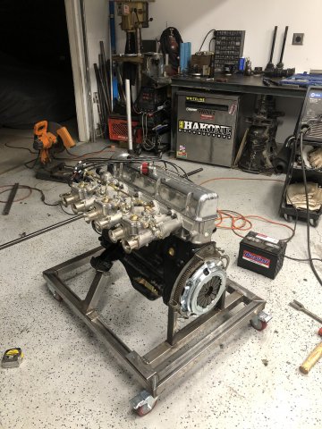

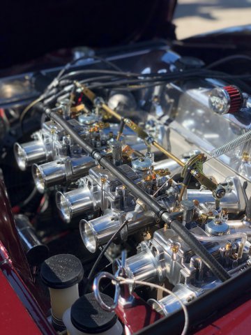

Hakone Motorsports 2 Posted June 23, 2019 Author Share Posted June 23, 2019 Got the 1 5/8” headers coated, swapped in a set of mikunis in place of the Weber’s. Got the test stand mostly sorted and about ready to fire the engine. Quote Link to post Share on other sites

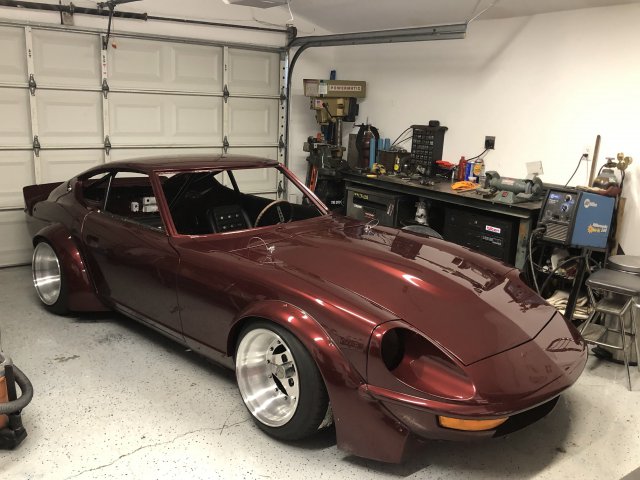

Hakone Motorsports 2 Posted September 14, 2019 Author Share Posted September 14, 2019 (edited) Got the car back from paint. Installed the engine and a couple other things. Edited September 14, 2019 by Hakone Motorsports 1 Quote Link to post Share on other sites

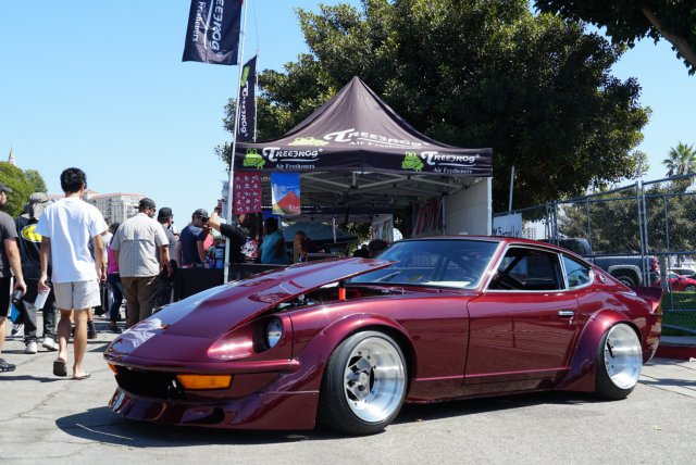

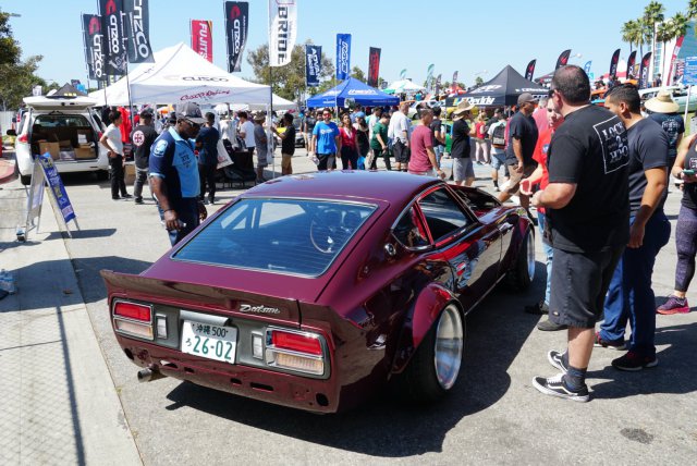

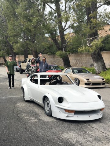

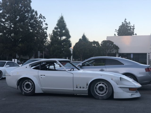

Hakone Motorsports 2 Posted September 23, 2019 Author Share Posted September 23, 2019 We made it to JCCS, Fam 1 Quote Link to post Share on other sites
Nelsonian 13 Posted September 23, 2019 Share Posted September 23, 2019 I saw that car there and was wondering if it was yours. It looked so good in the sun. Quote Link to post Share on other sites
