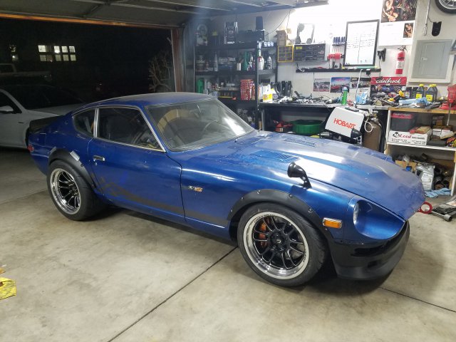

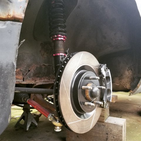

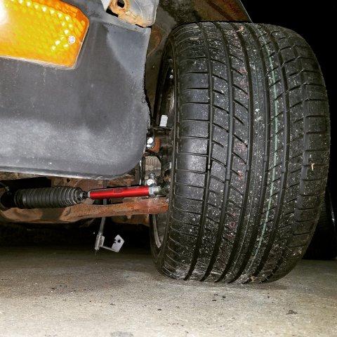

ride height will be a little higher than this... but i lowered it to almost maximum, just absolutely slammed with large portions of my fenders cut out...
And took a quick pic to show how much this setup corrects bump steer and roll center on very lowered 240z cars.
Part of it has to do with the placement of the tie rod in relation to the ball joint, and the other part of it has to do with the spindle pin being 2 inches higher in relation to the ball join...
Its essentially a drop spindle that has built in bumpsteer correction as well, especially when used with T3 tie rods.

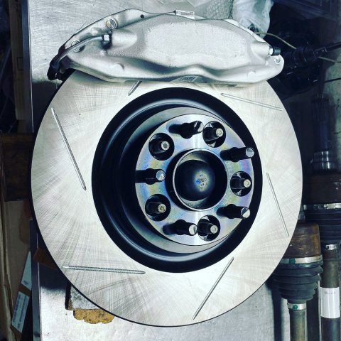

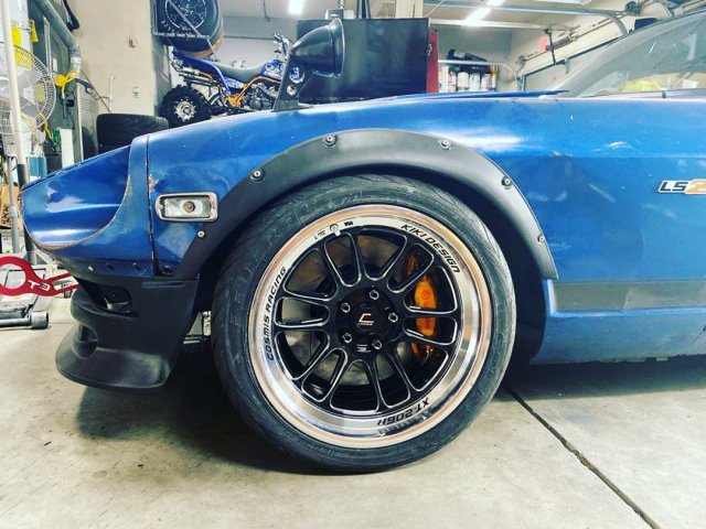

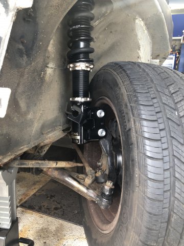

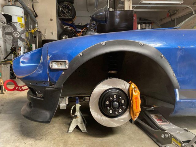

Chiming in after installing and putting a few miles on the mustang 5 lug swap. The install it’s self is fairly straight forward. One thing to note off the bat is this will move the wheel forward in the fender well about 3/4 of an inch. Not a huge issue if you are doing flares or If you are planning on smaller tires. I am running a tallish tire up front at 25.4” so my clearance may be more exaggerated than others. This seems to be the only side effect that I found installing everything.
Here is what I used
-2014 Mustang spindles w/ wheel hubs
-2014 Mustang LCA’s (only use the ends of them where the balljoint is
-Apex Engineering Bump Steer Kit (for these I found it best to grind the little lip off the taper to follow the taper to better engage the knuckle.)
-2003-2005 neon srt4 BC Coilovers (cut the ears off and made new ones to mate to the knuckle
-silvermine camber plates
-2012 GT500 Front Brembo Calipers
-Stoptech 14” rotors
-Hawk pads
The car drives great. Goes dead straight to 160mph. No weird vibrations. And I actually feel that my steering feels lighter with a 265 wide tire now compared to 225s.
Overall very happy with the swap. Brakes are badass. I don’t have the nasty vibration in my Steering wheel I used to have. Alignment was easy to setup. And I have all the adjustability I’d ever need
