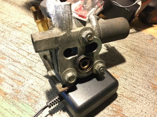

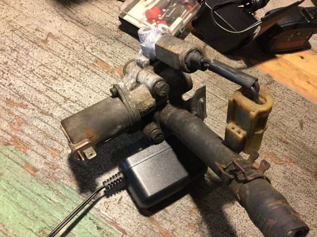

Here's the only photo I've been able to find of the assembly.
What year is your car. I pulled one off an 84T hoping it would fit on my 88T and they are differnt. That is turbo right? Also if you get one ask to see if the idle screw is frozen. That was why I was after one. I tried and tried to get mine unstuck.

I plan to adapt that assembly to my L28 by using the EGR block off plate and use it to control my idle with my '87 T 300zx ecu. If I could figure out of the 300zx ecu can control other AAC valves which is all I need. The FSM states it uses a 160hz signal. What was it about the 84 compared to 88 that was incompatible?
Curious. Are you using the 87T harness too?
It it was a different design. For what your doing it shouldn’t matter.

Were you able to test the to see if the valve would open at all even not connected to manifold or are the part numbers the same for the aac valve?
Share this post
Mine on my 88T works, I just can’t increase the idle with the screw. If I unplug it (the 2 prong connector on the fart left of the pic you posted) the car just dies.
I never tested the 84T when I realized it was different.
