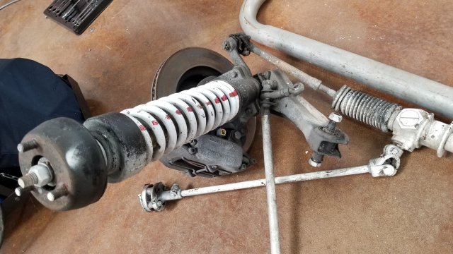

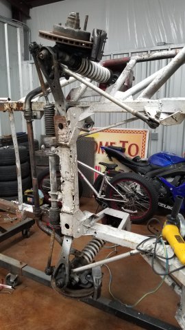

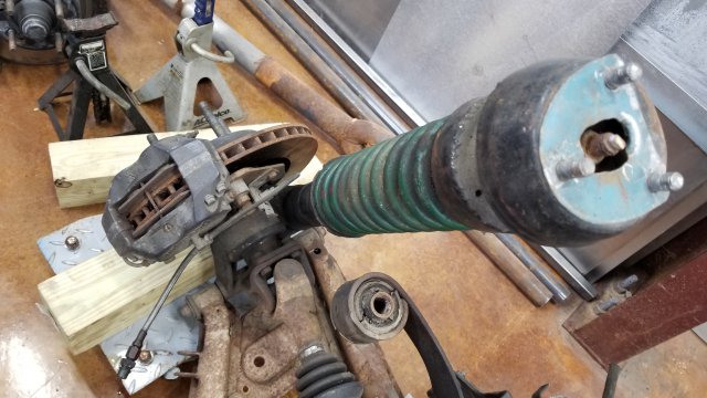

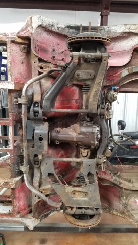

Gmagno 4 Posted April 27, 2018 Share Posted April 27, 2018 (edited) I am contemplating a new front/rear suspension for my 240Z race car. Wondering is anyone has experience with BC Racing products or can suggest an alternative. Below is the current setup I just removed. Thanks in advance for the help. Edited April 27, 2018 by Gmagno Quote Link to post Share on other sites
LLave 20 Posted April 27, 2018 Share Posted April 27, 2018 Off topic: wowah! Check out those tierod TC rods! Quote Link to post Share on other sites
seattlejester 32 Posted April 27, 2018 Share Posted April 27, 2018 ^Good eye, that is really cool, looks like the mounts are much simpler as well. Definitely an option for people who have rusted out buckets. I've heard the DR's offer better low speed response, but I'm not really sure for a race setup. The dampers at least in the BR don't feel like they react very quickly. There was a thread back where people talked about a company that offers race spec coilover conversion can't find it for the life of me, but other than that TTT comes to mind. Quote Link to post Share on other sites
