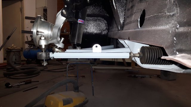

TUME 12 Posted March 1, 2019 Share Posted March 1, 2019 With S13 spindles (and others, i believe) and longer LCA:s is possible to achieve near zero scrub. At least not so wide wheels. I´v got 8" rim and scrub max. 10mm. You should keep about 50% ratio between caster and KPI. My car has 13-14 degrees KPI and ~7 dergees caster. Shock upper mount is moved outwards aswell... Quote Link to post Share on other sites

TUME 12 Posted May 25, 2019 Share Posted May 25, 2019 On 5/24/2019 at 6:40 AM, rbzed25 said: Would this work with control arms/ tie rods/TC Rods from Apex and/or T3? All attached to a stock Cross member? Trying to find a way to get rid of the front strut tube/spindle without breaking the bank with full T3/Apex Systems... and i like BC's. I've read through your build thread btw TUME, awesome work! Thanks for comments. Do you mean S13 control arms/TC rods. I can't see why they won't work, of course it is possible they need some modifications but nothing major. Of course left side arms goes to right, with S13 spindle and wise versa. Also because longer arms, there will be enormous KPI angle which affects camber behaviour when turning wheel. Thats why i modified shock upper mount in my car. Btw, those ultimate bolt-on set doesn't ring my bells... Quote Link to post Share on other sites
