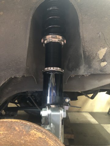

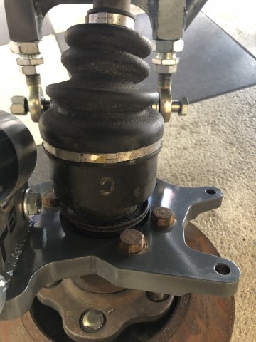

 I did this very thing. The deal to get the strut tube to clear the CV boot is to kick the bottom slightly to the rear. The strut isnt perpendicular to the ground anyway and leans slightly towards the front of the car at the top, so kicking it out at the bottom isnt a big deal. If you see in my picture, the strut is threaded way down. The way it is now, the car can be lowered way further than the stock BC setup. I might redo it in the future and slide the tube higher so I can weld it differently. You have to be careful not to put too much heat into the strut tube as to not warp the threads. Mine are still pretty tight due to the warping. I am not a pro welder, so a pro welder might do a better job at minimizing the warping. I dont have any clearance problems, but that may be due to making my own tabs to place the strut in a better position. I oversized the upper holes to give me some camber adjustment and the camber plates are now at center at ride height with 0 camber.
On another note, I think if I used a TIG welder, the results would be better.
20170904_192242.thumb.jpg.9905ee3e3123a3d74f2e50c414eba61e.jpg20170828_165935.thumb.jpg.6b296a1ba3fac065586a6dd5faa9b4cc.jpg20170829_123553.thumb.jpg.e0c24e67d7278004d1c659796efb1c52.jpg
Your rear setup looks great!  I appreciate your input regarding the requirements to run T3 style tabs on the lower BC Coilover Mount.  This is helpful...I’ll keep this thread updated as I make progress.

I’ll be updating this thread as I progress.  The BC Coilovers are new but they shipped me a set of fronts that are currently mocked up on the vehicle.  BC already sent me some replacement parts to swap out to correct this issue.  Once I get these swapped out and install the axles I’ll get some more photos up.  I am traveling for work so it will be a couple days.

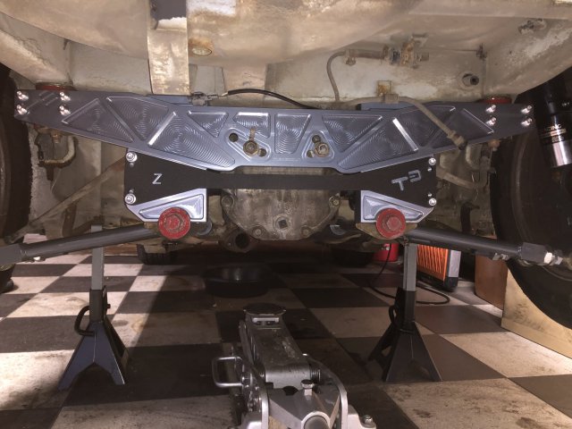

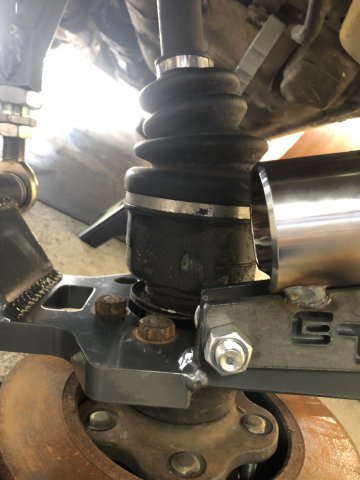

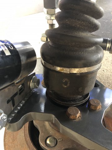

Thanks to those that reached out to me regarding the CV boots clearance on the lower BC coilover mount with T3 mounting tabs.   I returned from four days on the road and decided to tackle this dilemma...I previously mocked up the rear suspension and figured out BC sent me a set of front coilovers instead of rears.  I contacted BC while I was on the road and they were kind enough to send me a set of rear shocks and springs so I disassembled the rear and built it back up with the new parts while also incorporating T3 camber plates. To use the T3 camber plates T3 sent me bushings meant to integrate their camber plates with the BC coilovers...I decided I wanted to use the BC bushings instead so I took the BC nut and pillow bushing and turned (lathe) the bushing portion down to 15.76mm to fit inside the T3 bearing in their camber plate.
Next after building up the rear coilovers with the correct parts I mocked in an axle and I have good clearance on the CV boot.  I attribute this to the fact my lower mounts are likely front mounts and my T3 tabs extend beyond the lower end of the lower mount by a little over an inch or so.  My lower mounts have a reduction in diameter about 4 inches from the lower edge so I attached the T3 mounting tabs even with the upper edge of the larger diameter on the lower mount.  I posted up a few photos to illustrate what I’m talking about.  With the T3 camber plates and T3 lower control arms I don’t anticipate any issue with camber adjustment either.

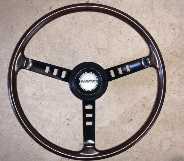

I did take a little diversion to restore a 240Z steering wheel that I plan to use...I bead blasted the metal to remove old paint and surface rust.  Next I repainted the spokes with POR15 satin black.  After a day to dry/cure, I sanded the simulated wood and newly painted surfaces with 600 grit and applied thee coats of satin clear coat.  I am extremely pleased with the outcome...too bad I’m likely a year away from installing it but it is gratifying and does help to keep me motivated.

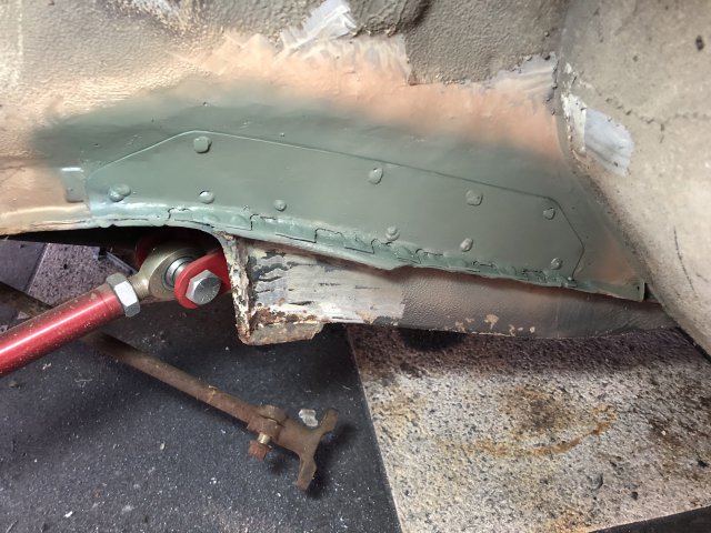

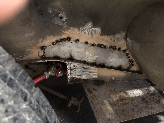

Not very glamorous but very necessary...removed the reinforcement panel to get to the obvious rust behind it.  Cut out the rust damaged panel then fabricated a replacement panel. Butt welded (tacked in) te patch panel.  Still need to complete the welding then fabricate the new reinforcement panel to install over the patch panel.  Not sure what the reinforcement panel actually does as it was original fabricate from very light 20 gauge material.  Anyway, the new patch panel and reinforcement panels are going to be 18ga so they will have greater structural strength then the original stuff.

16 minutes ago, fluidmotion said:
Nice patch.  Had to do the same on mine.  Perhaps Datsun knew those panels would be prone to rust and added extra material haha.
Thanks! I think the reinforcement and the failure of its seam sealer is the cause of the rust in this area.

Here are a couple photos of my BC Racing coilovers mocked up in the rear of my car...to cure the clearance issue with the cv joint I lowered the T3 tabs so the are off the end of the BC weld on mount.  As far as camber issue my T3 lower control arm are currently extended out on the bottom and the T3 camber plates are adjusted out, once the lower control arms are adjusted in the upper camber plates will bring the rear camber in spec.  I’m very pleased with the mock up and happy to be able to use BC stuff on all four corners.
