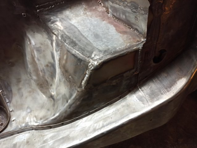

since the last update, i finished up the front of the frame legs and the area on the driver side above the frame leg
welded upp the last of the battery tray area
and started finishing up the area where the fuel filler neck usually goes as mine will be behind the numberplate

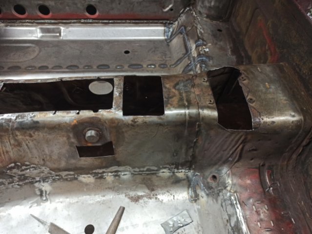

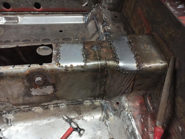

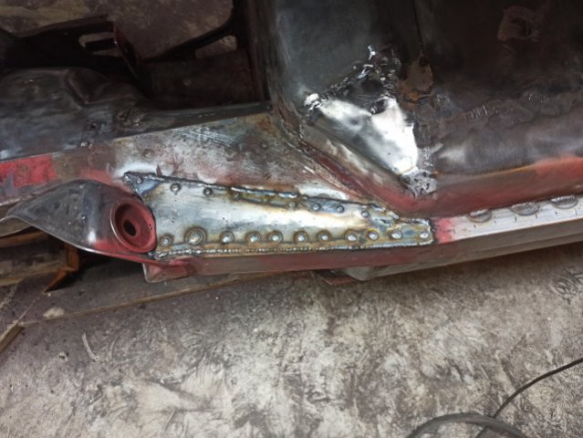

Got some more done on the car, finished up the rear of the framelegs endplates, i also went over some of my floor welds that needed it.
217948553_2020-05-0313_12_00.jpg.eb8aa0ab0c1b813293b710f4a808c668.jpg2140182629_2020-05-0313_12_04.jpg.90a4b2b55d3923b0e45485104bbc0383.jpg
117883047_2020-05-0313_12_25.jpg.5a1216754c14658ebf32759f5eb07261.jpg586432915_2020-05-0313_12_28.jpg.c8e2310d3787f970e50e4d9871daa87f.jpg

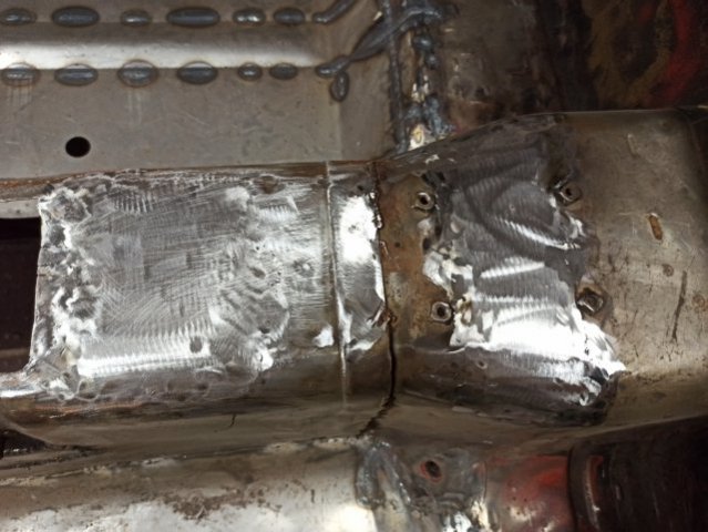

and some cleaning up of my welds, still some left to do but my angelgrinder wont fit

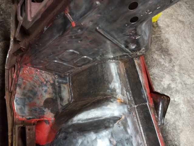

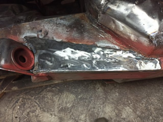

i also cleaned up the front inner plates
