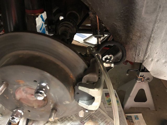

Hi Miles,
Even though I tightened bleeder nipple as tight as I can, brake fluid keep coming out when I press brake pedal.
So, I swap back nipple and brake hose input to original location.
I put brake caliper flat to make nipple facing up to bleed air, then mount it onto the maxima bracket now.

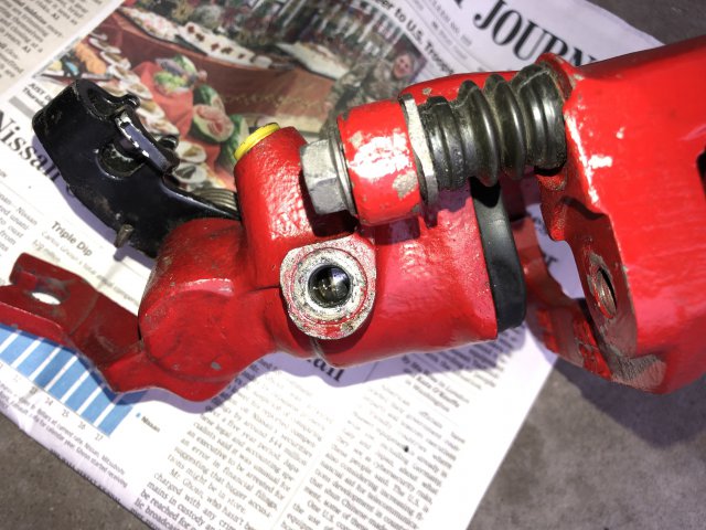

Post a clear sharp picture showing where the bleeder and brake line is installed on the caliper.

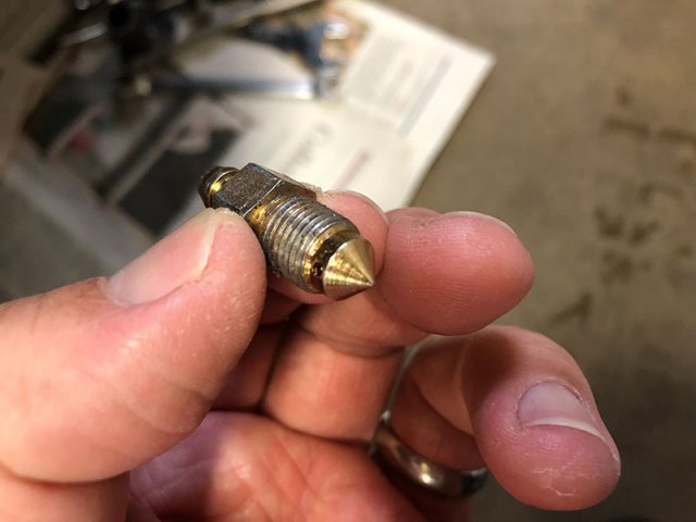

It might help to get in to the details of how the bleeder screws work.  There's a narrow cone shaped seat on the bottom of the screw that plugs the hole in the caliper.  When you loosen the screw the fluid is released and flows in to the small hole next to the screw seat then up through the middle of the bleeder screw.  All that matters for stopping leaks is how the cone shaped seat fits in to the hole.  Reman calipers often have poor seats for the screw.  So inspect the hole carefully, and make sure that the seats are clean and smooth.  You should not have to tighten the screws very much if the sealing surfaces are in good shape.
Here's a picture I stole from the internet and where I got it.  I don't know if I agree with the guy but he takes a good picture.  I added some red lines to show the gouge in the screw from where it seats in the caliper.
http://www.eatsleeptinker.com/2014/05/15/brake-bleed-valves/
Share this post
Another view of how a bleeder seals when tightened.
Note tapered portion of bleeder screw and the tapered seat inside the  bleeder passage.
When the tapered part of the bleeder and the seat mate and are tightened the bleeder is sealed.
If the mating surfaces are damaged,  or dirty , the seat and bleeder screw will not seal.
cimg7183_1024x768__e6bf1d225cd68d1b633d440fba03b2714c921bee.thumb.jpg.58f7024488f6b60c767dd0f78f6b2d31.jpg

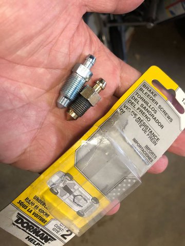

Thanks NewZed and Miles.
The speed bleeder nipple is so short. and DORMAN's OEM version is a bit longer than original.
I tried both to put it into the brake hose port. It looks like both bleeder nipples not even touching at the tapered section at all.

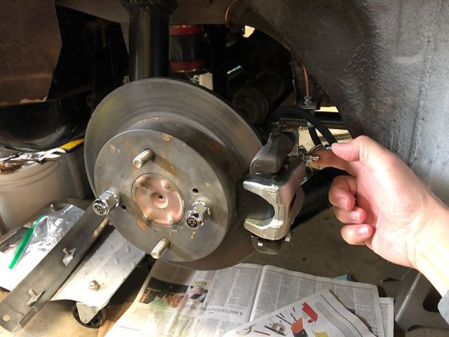

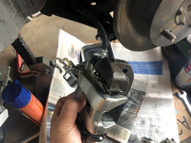

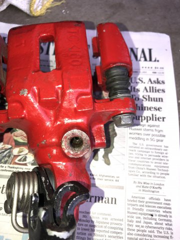

I made some notes on the  picture you posted.  The bleeder is pointing up as it should be.  Check the brake hose and make sure that  as the suspension moves the hose does not rub on the frame.
It doesn't look like you have connected the parking brake cable to the caliper. Also, I don't see the parking brake bracket installed on  the caliper.
Suggest that once the hose and parking brake cable are connected that you place a floor jack under the control arm (below the strut) and move the suspension up and down slowly checking for  the brake hose or parking bracket hitting the frame.
As far as the bleeder leaking issue goes,  check the internal bleeder mating surface in each caliper. If the mating surfaces are damaged or not machined correctly return both calipers and replace with  a different brand.

Thanks Miles.

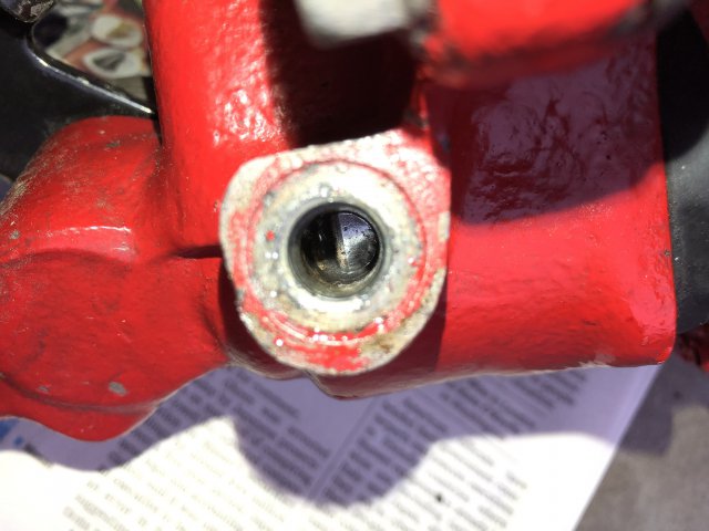

The mystery is solved.
The bottom of the brake hose port is not tapered at all. I can see the brake piston.
The nipple port has tapered end at the bottom.
That's why no matter what nipple I use, no matter how hard I tightened in it did not stop bleeding when I swap nipple and brake hose port.

I haven't hooked up Ebrake cable yet. I replace original cable to 280zx cable since the e-brake cable end shape is different.
