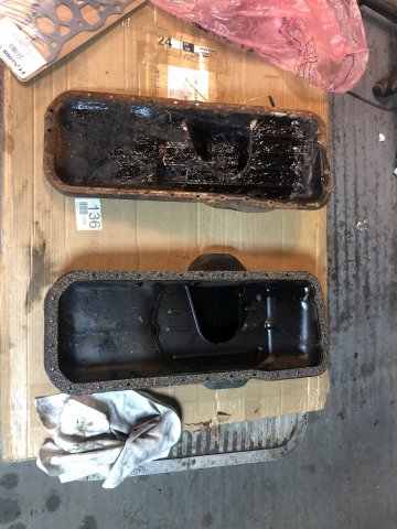

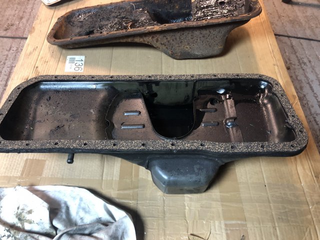

I'm Also looking for an oil pan but currently pondering whether i should just modify an oem pan.
