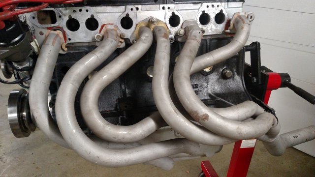

That's what I built, I regularly get comments at the track with people saying how great it sounds and wondering if im revving to 10000 rpm.
Taught myself to weld so it took a long time to build. Hundreds of hours of work.

This is exactly what I was looking for was it paired by 1-6, 5-2, 3-4 ? And what if you didn’t combine all into one collecter and had three pipes going out and connected them with two y pipes or three straight pipes out the back

Your pairing is correct. 6-3-1 is suppose to be better for midrange, It was recommended by a ex British touring car engineer I work with. If you don't run them together (at the correct length) to 1 tube you will sacrifice power. I wouldn't recommend three pipes. Is this going to be for a race car or street?

Street, and it would be three collectors where they are all separate but then either adjoined later by y pipes I’m purely curious to how it would sound as I haven’t seen it done. I don’t mind losing power I’m looking. For a unique sound almost like how 180 degree headers change the tone of a v8 what would doing this do? In theory couldn’t you make a similar tone change if you paired certain Cylinders ?
