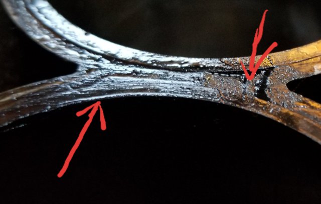

So I know I'm on a Z forum and I got a few Zs but this question is about a 2001 Honda Civic Vtec.  I bought the car for cheap to use it as a commuter car. It had a blown head gasket and chocolate milk for oil. When I pulled the head I was obviously expecting a blown head gasket in which it was, but it also has a damaged block with missing material between the cylinders. Can this be repaired or should I get one of those jdm motors pulled from japan that is supposed to have low miles for like $600... Looks like I have a few stuck valves too. Shitty night finding this. Just looking for second opinions.

Is the spot where the head gasket blew out the same location as where the block has pitting between the cylinders?
If so, you can either get someone (or do it yourself) to weld in between the cylinder walls to fill in that gap and then smooth it down...or you can save yourself a ton of time and effort and just get a new engine.

That tiny divot between the tops of the cylinder sleeves probably doesn't matter.  The sleeves do the work.  Look at how thin the material is between the sleeves and the cooling passages.
Probably be more clear if you wipe the dirty oil off and put a flat edge on the sleeve ends.
The opposing spot on the cylinder head is probably of more concern.

The spot where the head gasket completely blew apart in the middle is the exact spot where the divot in the block is. Should all the valves be seated in the head when the cam gear is set to TDC? There is a few popping out slightly. The PO said the car used to run rough before the head gasket blew, that could have been that issue. He also said he remembers seeing a brand new head gaskets on the car when he bought it used, as if this is the 2nd blown head gasket. Motor has 188k miles.

Looking at the block again, I would definitely run that as is. Head gasket seals along the rims of the cylinders, that part is just a bit rusted away because of coolant exposure. As long as the valves don't have any problems, just clean it up, check for flatness, and slap another gasket on there.

Well the machine shop guy was honest. Said he wouldn't do any head work after seeing these pictures up close. If you look close enough, part of the cylinder walls have deep grooves on the tops not just the cast section in the middle.
Why would the machine shop guy talk about the head when you showed him pictures of the block and cylinders?   And don't you have a rag or a paper towel even?  Why don't you clean things up so that you can see?  Everything's covered in dirty oil.  And you're talking about welding the tops of the sleeves now.  That's a whole different thing.
Anyway, good luck.  There's probably a ton out there on the internet about rebuilding a 2001 Honda Civic Vtec engine, and that type of damage is probably common.  I'd get on a Honda site if you want experienced advice.  There is a proper procedure to follow for evaluating parts during a rebuild, and measurements to take to determine if they can be reconditioned..  Nothing that we've written here really helps you much.  You can't just weld up a thin area like that without warpage.  You'd be wasting time and money even if you could figure out how to separately weld the steel, then the aluminum.
That divot in the aluminum, the second arrow, looks like an incomplete casting actually.  Not caused by the HG blowing.  Normal.  Probably the same on hundreds of other blocks.

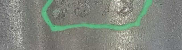

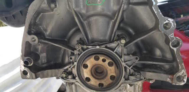

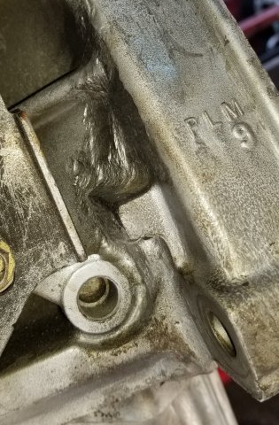

Well wasted part of a Saturday. This new motor from the high priced junk yard is a POS. I told the guy to give me a good motor and check it good because I didn't want to waste each others time bringing it back. "We checked it out it's a great motor, there ain't nothin wrong with this motor". So I get it home and decide to change the rear main seal when I start looking closer and see that this $550 used junk yard motor has been cracked and repaired/welded and painted around the bell housing area. The guy told me that the fly wheel was damaged but the motor was good, I got to thinking why was the fly wheel was damaged at the time but he assured me just to use my flywheel and I would be fine.
If you look at the dates circled in the bell housing it says 4/2018 and its crossed out then 4 months later it says 8/2018 in the same area. Thats telling me that the PO had to bring this thing into the shop twice for the same problem, next the car is found in the junk yard and it's not wrecked.   Something probably not lining up correctly after the case damage, a crank problem or the way everything mounts up could be off center. I already wasted a few hours getting this new motor ready, bought another $75 in gaskets and seals (luckily didn't install them)...I dont want to spend hours putting this damn thing together and back in my car only to have to pull it out again. Its loaded in my truck and ready to go back to the junk yard Monday morning. The receipt says they charge a 25% restocking fee to get a refund, we will see about that..Back to square one.
