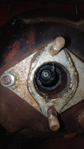

Question, this picture is in reference to the flange on the master correct? So between this and the booster there should be the aluminum spacer right?
Share this post
Posted (edited)
You measure from the face of the aluminum spacer on the booster to the tip of the push rod.
So,  if you replaced the stock 7/8 MC with a 15/16  MC, which has a deeper socket,  you adjust the push rod out 0.53"as measured from from the face of the aluminum spacer.
The 0.53" is a starting point.  You may have to fine tune the push rod length by making small changes and then road test the car to make sure the rod is as close as possible to the bottom of the MC socket without pushing the piston too far inward which will cause the brakes to drag or lockup.
If the push rod is adjusted too long, the piston will block the return port in the MC and the brakes  lock up after 2 or 3 stops.  If this happens, open the MC bleeders to relieve the built up fluid pressure, limp home,  and adjust the push rod a little shorter etc etc.
If the pedal  moves too much before engaging the MC you will need to lengthen the push rod in small increments.
Note that you do not have to remove the MC to perform this adjustment. Just remove the mounting nuts and then pull the MC out and push it aside.
There is also a tool to measure push rod  length.
