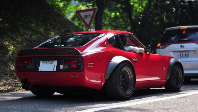

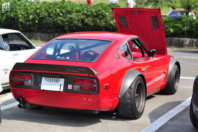

RustyS30 0 Posted May 16, 2019 Share Posted May 16, 2019 Front wheel looks suspiciously small, unsure of what size front and rear might be so just want to hear what everybody else thinks before I purchase. Quote Link to post Share on other sites
zboi 0 Posted May 29, 2019 Share Posted May 29, 2019 16x8 I'd guess, with whatever the maximum possible negative offset is. May not even be stock suspension, look how little of the tire is actually in the rear wheel well. Quote Link to post Share on other sites
Ereschkigal 0 Posted May 31, 2019 Share Posted May 31, 2019 1. These are extra wide fenders, which makes if more diffucult 2. You could look here for inspiration http://www.rs-watanabe.co.jp/category/userphoto/nissan/フェアレディ/ (haven't found extra wide fenders) 3. 8 inch wheels only get produces to a max offset of -6: http://www.rs-watanabe.co.jp/products/wheel/eightsporkRtype/ So the wheels have extra spacers or are wider. Quote Link to post Share on other sites
tamo3 2 Posted May 31, 2019 Share Posted May 31, 2019 (edited) I use 16x8.5 -6 offset in front and 16x9.0 -13 offset in rear with regular flare, no spacer in rear. My guess is this red Z is 16x9.0 in rear which with some fat spacer. The depth of wheel looks like same as mine. Edited May 31, 2019 by tamo3 Quote Link to post Share on other sites

ARiskyCvt 12 Posted June 1, 2019 Share Posted June 1, 2019 The red ones are watanabes, you can tell from the lips and I have yet to see a true Japanese person rocking knock off watanabe. That’s be silly Quote Link to post Share on other sites
