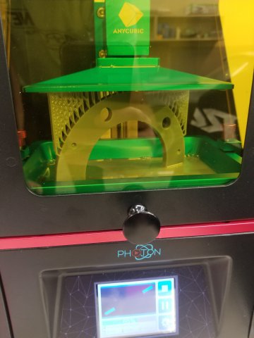

6.5mm. I think on the second iteration I'm going to go thicker so I can countersink the bolt heads. I've yet to throw the hub on the upright to check for clearance and how to mount the sensor, but I don't foresee any issues there.

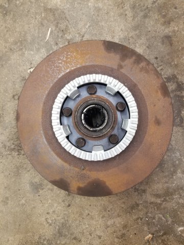

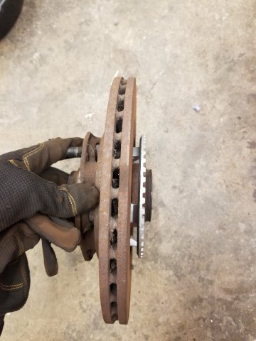

One more hurdle is that the test fit was on 300ZX turbo hubs. I don't have a pair of 240Z five lug hubs to check clearance on, so the rotor clearance could be different there. Maybe I'll pull off my 4-lug hubs this weekend and give it a look.

Do you know what the rotor bolt pattern is? Stock is 4x103mm, and the 300zx hubs are 5x103mm. SilverMine uses the 5x103mm pattern on their hubs, but I can't find measurements for AZC or T3.
I did find SilverMine blog post from 5 years ago claiming T3 uses 5x3.85", which would limit rotor choices to only T3 stuff. They may have updated since then.

So, it turns out the hole pattern isn't that oddball. It seems to be simply 5x110, but one of the threaded holes on the tone ring is drilled off-center. This caused a bunch of headaches until I figured it out. Always nice when OEM parts have issues.
Drawing is attached. You might be able to tighten up the radii of the bolt holes a bit, but it all depends on what type of tolerance for part imperfections you want. Thickness and countersinking would depend on your material and application, so I left that out of the drawing. The inner and outer radii of the adapter itself don't need to be exact, and might actually very depending on your hub and rotor. Basically, everything in here other than the 5-hole patterns aren't test fit for other applications, so use without verifying at your own risk.

I emailed T3 and confirmed with them that they use the standard 5x103 pattern, so that's great news.
I also test fit the hubs onto my car over the weekend. With the turbo hubs, they clear the dust shield by over an inch. That means they might get pretty close the the spindle with 5-lug 280Z hubs since they're lower offset, but I think you could play with the adapter thickness to get clearance if necessary.
The round part of the spindle is not much smaller than the tone ring, so some clearancing might have to be done to get a sensor in the right spot.
