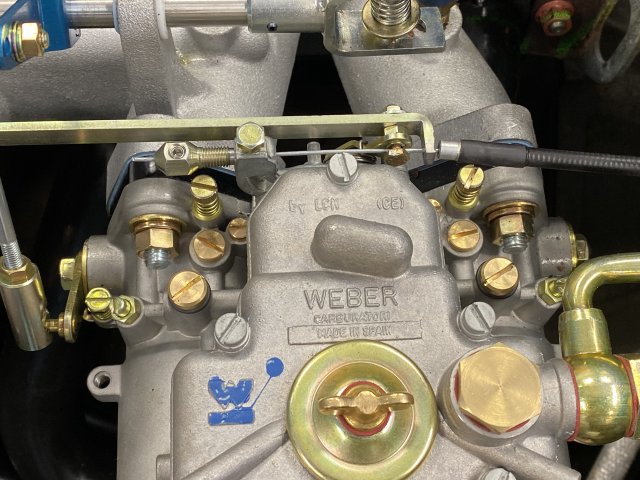

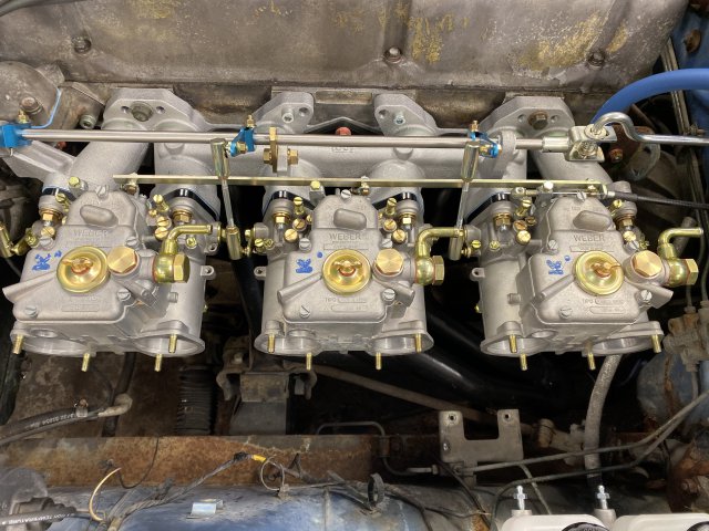

Reverse cable action on Weber triples.
I am doing a big job for a customer at my shop and decided to take a different route with the choke action on triple 45’s. I have done the long cable around to the 1st carb and the lever/bell crank action on the 1st rod end but neither were as neat and clean as this in my opinion. Now I do have a set of right hand action N.O.S. Weber enrichment levers but I can’t stand to use them. I think this is the next best thing.
I have a parking brake cable boot coming I will put on the nipple coming out of the fire wall and think I will add a cable receiver to the end of the link rod to make that look a little more finished but overall very happy with the way this came out.

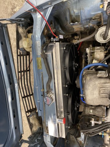

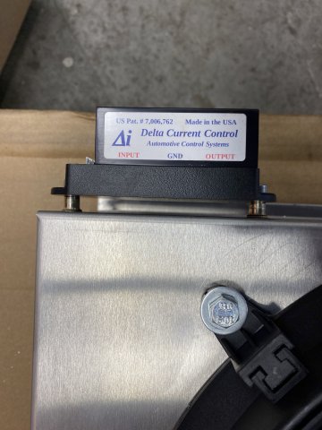

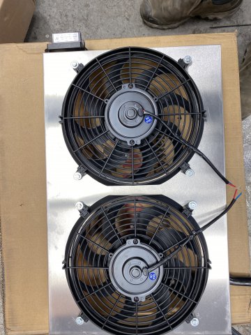

This car car is getting t3 front and rear brakes, wilwood master cyl, auto to 240sx 5speed conversion with aluminum driveshaft shop shaft, lowered springs. Shocks, 16” panasports,  aluminum radiator with dual electric fans & dc controls continuously variable cooling fan speed controller. That is round 1.

What’s your point? Because you had a rich enough mixture to produce a satisfactory cold start doesn’t mean it was the correct way to do it. All the old Porsche carbureted cars have no cold enrichment device. When set up with a ideal idle mixture while hot it is hard to start when cold so you compromise the warm mixture to help you start it. This is a customer car with carbs that came with a cold enrichment device that I chose to have operational for the customer and was demonstrating the way I did it for other people who want to run it on theirs.
Doesn't mean its incorrect either! Weber DCOE's have an accelerator pump that is activated when the throttle level is pushed from closed position. So unless you are running a large ratio of bleed back valve to pump jet size only a couple of pumps are required to adequately prime the engine for startup or in the higher ratio case a few extra pumps on the throttle.
Edited by JohnH
It kind of does.  Im not saying it’s not done or doable. Like I said Porsche did it on production cars. In that case they did give you a mechanical lever to raise idle by simply pulling on the throttle cable. This helped keep the motor running and sped up the warming process.
   A motor when cold requires a LOT of extra fuel to run correctly. This shows up the most at idle when it can easily stall. The accelerator pump will give it the shot of fuel it needs to ignite but after that your motor does not run/idle well. You can continue to tap the pedal to add accelerator pump fuel and help out. I am not saying it doesn’t work or that I haven’t done it but there are better ways to start a engine. When you have a cold enrichment devise already installed why not take advantage of it. A motor set up with the correct 12.5-14.7 ratio usually on one of these old L6’s they idle pretty well warm with a high 13’s to low 14’s idle mixture. This same mixture will not work nearly as well on a cold motor. Especially if you live where temps in winter can be near zero.
