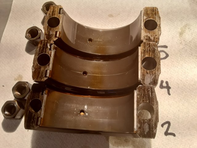

alex44 1 Posted November 23 can i get some advice on the condition of these bearings? im not exactly liking that scratch on number 4 i can catch my nail on it.. number 2 looks like normal wear right? https://ibb.co/xjJwLDZ Quote Share this post Link to post Share on other sites
seattlejester 30 Posted November 23 There is some wear, but it looks like they still have their coating. Quote Share this post Link to post Share on other sites
grannyknot 21 Posted November 23 Those don't look too bad at all, as long as there is not a corresponding scratch on the journal, what does the other side of the bearing look like? Quite often it is the upper half of the bearing that takes most of the wear. Quote Share this post Link to post Share on other sites
alex44 1 Posted November 24 8 minutes ago, grannyknot said: Those don't look too bad at all, as long as there is not a corresponding scratch on the journal, what does the other side of the bearing look like? Quite often it is the upper half of the bearing that takes most of the wear. The upper half of the rod bearings had a bit more wear but nothing crazy, no shiny spots or copper colored patches they all looked like that. Lol so we've decided to cross our fingers and bolt it back up, just got the bearings torqued and put the oil pan back on after cleaning it until spotless, filled it up with oil and new filter next I got to extract 2 exhaust studs then we will put the intake/exhaust on and start it up.. wish me luck I'm praying to the z gods! Quote Share this post Link to post Share on other sites
