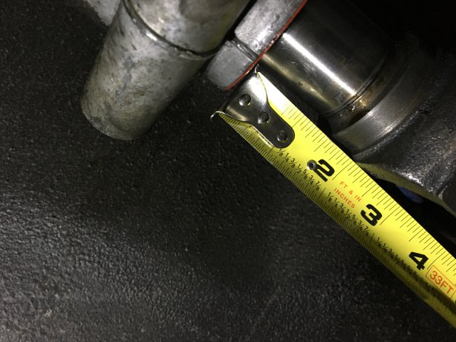

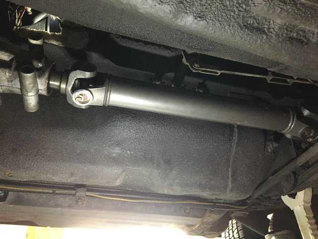

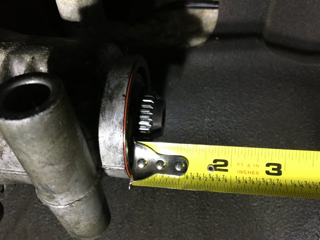

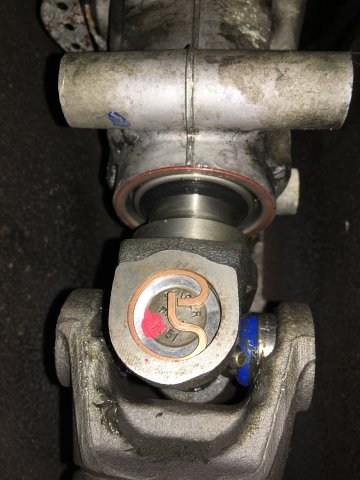

Here are some more measurements.  The transmission shaft sticks out about a 1/4 to 1/2”. The yoke is about 3 3/4” and the splines go all the way to the edge
I can’t math real gud but that leaves about 2 1/2” of spline contact.
My gap is 1 1/2” If the normal gap is 3/4” would it be worth redoing the shaft to add 3/4” more contact?
1E34A057-CF1A-4201-9FCE-F8E3F624842E.jpeg.ba850ebc5dd109d31bd4a0f0bee36526.jpeg189A2471-E480-4410-BF95-CA2BF437189A.jpeg.66c763424afd933c0f8e33a8fc9fd2c2.jpeg
I hear you, in my case I had no choice. Mine was leaking from the rear seal. I replaced the seal twice and still leaked. I was also told that not having proper engagement could damage the transmission bearings in time. You can always try it like I did, if you have no leaks or vibrations you may be ok.
