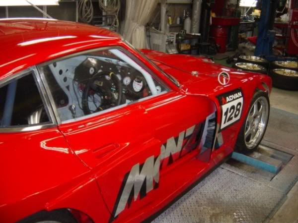

Zlalomz, you come in and clarify the idea once again with a picture of a perfect example of what is in our heads. You must have an exorbinant amount of Z pictures at your disposal. This is EXACTLY the type of look we are going after and shows exactly the type of application you can do with most any flares; even those sixty's huge Volks Bettle Ferrari type add ons. I prefer this (with a little rounding off) to my old Z body kit.
Now, remove the wing and add a 3" 3-piece spoiler and you have a great overall Z shape. Can you imagine that Z with a hugely bumpity-bump cam and flowmasters pulled up next to a Viper at a light. I think he would end up writing Lee Iacocca a letter.
If our my minds weren't made up as yet; They certainly are now. Thanks much!!
