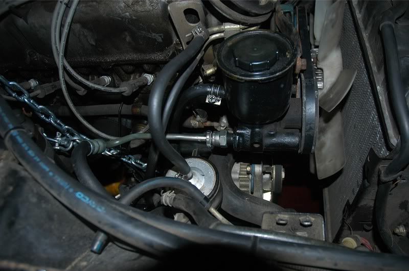

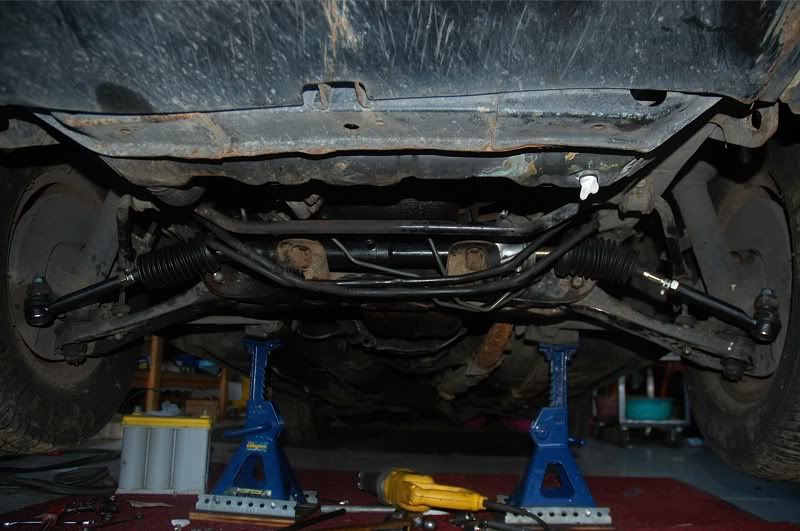

Subaru Power steering rack in a stock L-28 powered S-30…
Update;
First, I’d like to thank Wheelman for all his help and efforts in making this a reality and also thank you to RonTyler for the ZX pump components. ~ZchicaDee~ also thanks you both…
Car; ’78 Black Pearl edition 280-Z coupe, factory A/C, 5 speed. Car is stock throughout with poly T’C rod bushings and poly steering coupler otherwise the car is totally bone stock.
Owner, HybridZ member ~ZchicaDee~, close family friend, essentially family, unofficial adopted daughter :wink: This is her first Z! :2thumbs:
The rack is out of a ’92 Suby Loyale, 3.75 turns lock to lock, (ratio is bit slow for some, but perfect for this particular application). P/S pump and pump bracket, belt tensioner, crank damper, and clutch fan are out of an ’83 280-ZX. The hoses and fluid lines are the Suby Loyale hoses. Low pressure hose fit the Datsun pump reservoir perfectly, (10mm). For the high pressure fitment to the pump I had “Oil Filter Service” in Portland weld the Datsun H/P fitting for the ZX pump onto the Suby hard line. Looks OE.
http://www.oilfilterserviceco.com/
Cross member was notched to clear the PS lines and steering input. We then fabbed up patches that were welded in the notches to regain any strength that may have been lost in the notching process.
brand new Toyota Celica inner tie rods, brand new Suby Forrester outer tie rod ends. Utilized the Suby steering shaft U-joint, welded it to the Datsun steering shaft. (Suby U-joint component was hollow so I machined a steel bushing that fits inside the suby part and slips over the Datsun shaft which was then all welded together, thoroughly!)
All that is left to do is to tighten up the front LCA hardware, reinstall the charcoal canister in a new location and test drive.
Here are a couple pics from tonight. I have one of the pump and belt assy, but struggling with this %$*&’en family iMac and getting it to SAVE the picture in portrait position vs landscape!!!

Hey Braap, what's that dog chain for? :)
Wheelman
Ken,
Chain the engine down so it doesn't flip over on launch, of course... :lmao:
Actually, being as we did this PS conversion with the engine in the car, I built a wooden engine holder out of a 4x4 that spanned and sat on top of the strut towers to support the weight of the engine while we swapped out the cross member.
