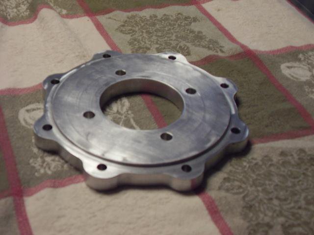

Alright boys, we're making progress! I'll bring the hat back to the shop on friday for final trimming and measuring, then it's back to Sparky again for the mount up on an actual car. Then, we get a whole batch made :burnout:

Now to what your going to need to complete this kit:
Caliper (x2)-Wilwood or other caliper with a 3.5" mount spacing for a 1.25" thick rotor.
Rotor (x2) 12.19" Diameter Rotor with 8x7 bolt pattern (lots of choices on this one)
Brake lines (x2)- there are several shops that can custom make you a set of brake lines to adapt from the stock hard line to the caliper. When I get everything put on the car I will be able to provide more detailed info on this so people wont have to guess or fiddle too much.
Brake pads
late 260(?) or 280Z Hubs- The spacing is different on the stock 240Z or early 260Z hubs so they will not work properly. I'm making sure my info is correct on the late 260 hub, its really best to just buy a set of 280Z hubs and have new bearings pressed in...its very affordable all will offer a nice piece of mind knowing that everything up front has been gone through. Also, your going to have everything apart anyway so why not?
Nuts and Bolts- there are 8 bolts that connect the rotor to the hub. and another two for the caliper. these can be sourced locally or online but its imperative that everyone understands the difference in bolt grades between metric and SAE. I will be making a post about this when we start taking orders and asking everyone and anyone that buys that kit if they understand. Secondarily, I'm looking into a single manufacture that can supply us with a bolt kit and cut us a bit of a break...stay tuned for that one.

I talked to my shop tonight, annodizing is a go.
After getting the hat from Sparky, I've changed a few measurements by a hair. I want to send it back to Sparky so he can bolt it up to the car, but after that we're ready to submit the order to the shop.
So if I'm not terribly mistaken, we're looking at 3 weeks.
I have just one question - why engineer this when Wilwood have a listing for a Hat for the Z. The part number is 170-1754. See page 25 of this PDF price list http://www.wilwood.org/racerpricelist.pdf
The specs of this hat are - 1.41" offset (not sure if that is for a 240z hub or 280z hub) 4x4.50 PDC on 8 x 7.00"
So if the offset is the same as the one you guys are making then this would be the same just a little bit more $$ (as your kit includes the caliper braket correct?) but this might be good for us non US based guys?
That Wilwood hat sandwiches between the wheel and the hub face, changing the front wheel offset. A member here has installed a set (front and rear I believe) with some success, but with fabrication remaining. I can not comment on the exact means of installation, but it is an option to consider if you have a good connection or can find them used. you will need to fab up a bracket and play with the setup though....

As soon as I get the final prototype back and bolted to the car I will get you exact figures.
