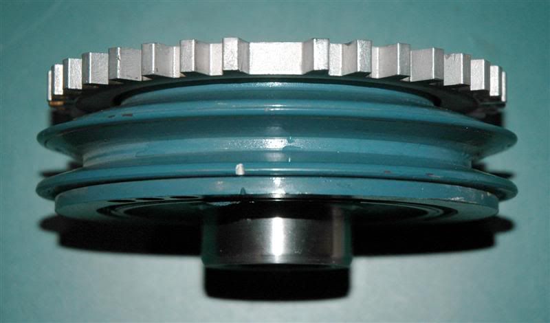

Here is an old Datsun 280 Z damper before, during, and after, being modified to accept the Ford Escort 36-1 wheel… This was for mock up, then I machined a brand new damper for the race car which is pictured below these…
This is the brand new Nissan pulley that is currently on our Race car.
