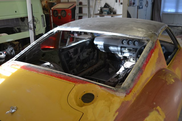

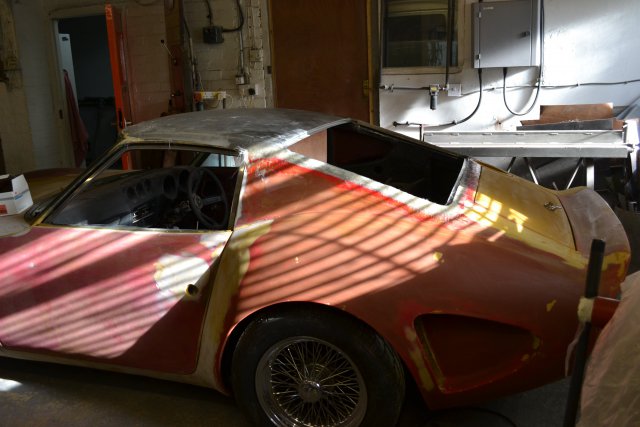

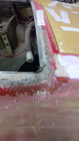

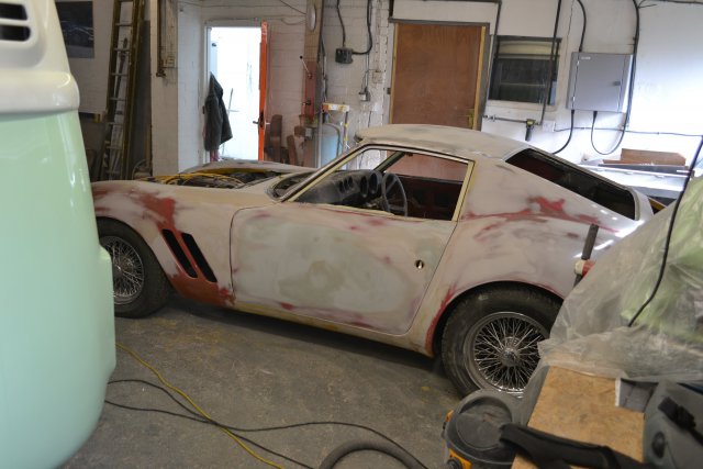

I have managed to do a bit more on the car this week,
I try to keep Fridays for working on my own stuff and Sat mornings, if lucky I can snatch a couple of hours here and there during the rest of the week. I got the rear window frame glued, riveted and glassed in place, most of the old primer off and started the hateful job of getting the body shaped up.
Some pics for those interested (seems to be 2 at the moment lol) oh and a couple of pics were taken on myphone so quality not great.
I have some more pics on my camera, but it is at work so will update later on in the week.
I have decided not to mod the doors, it does make the car look great but the work involved moving the A pillar back is a lot, plus if I did that I would have to do the sliding window mod and at the moment I have doors that open and shut well, should have no wind noise or leak.
I am also going to leave the fuel filler on the drivers side, again more for ease of the build plus I want to be able to use the boot space as much as possible.

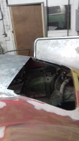

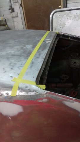

Did you reattach the the rear turret cross-member or did you recreate something new? A novel and seemingly practical approach either way to create a larger window opening.

Regarding the roof mod, I dumped the old bit I cut off as it was quite heavy, I made a thin top hat section up and curved it to the roof profile, then I bonded it in place and made some L shaped brackets to attach it to the inner cant rail inside the car. I will get a pic tomorrow for you.

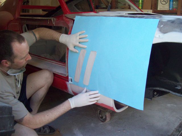

Here is another rather straightforward mod you may want to consider.If you are trying to create the appearance of a longer front guard (wing, fender) try repositioning narrower vent slots rear-ward. I think it worked somewhat on mine.

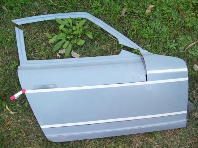

My doors were a major undertaking but as prototypes I expected that. It you want information on how I would go about it again let me know. Basically I purchased fibreglass doors and chopped 50mm off the top and 50mm above the crease in the panel, that was between the lower hinge mount position and the bottom edge of the door structure. I left them original at the 'A' pillar and kind of hide the change of height with the rearview mirror.
I also made the outer skin removable (like newer VWs) so I can adjust it to match the front guard (wing, fender) and the rear panel.

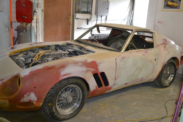

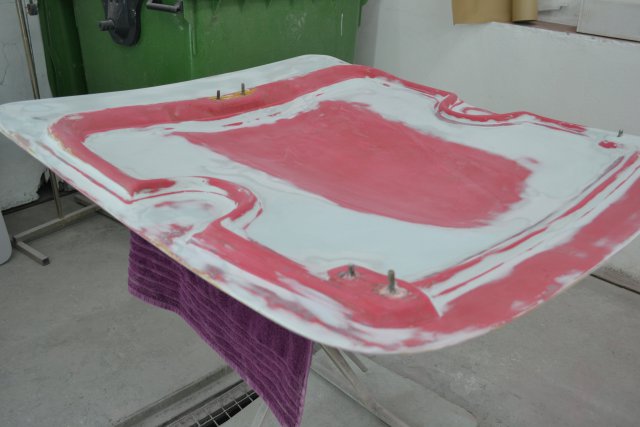

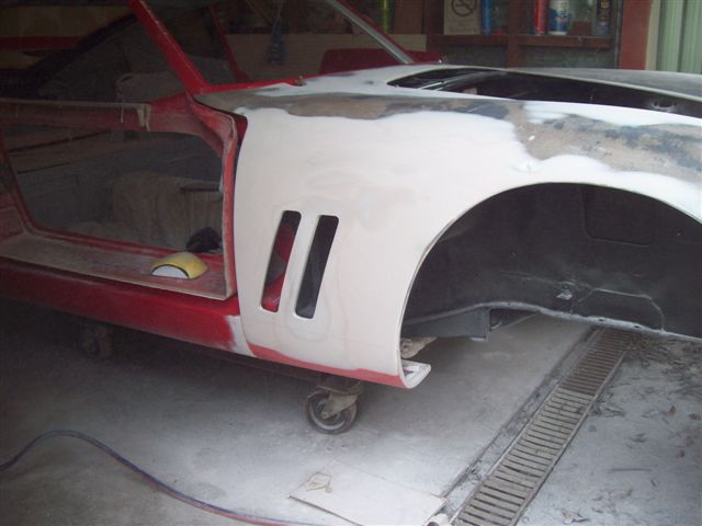

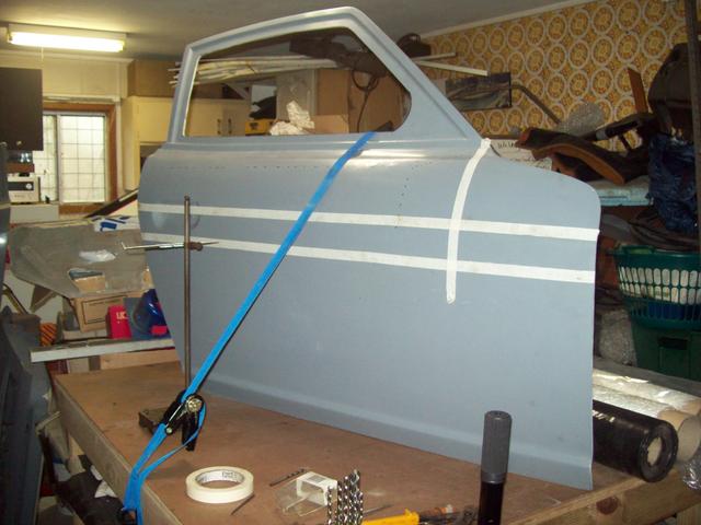

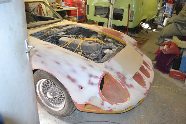

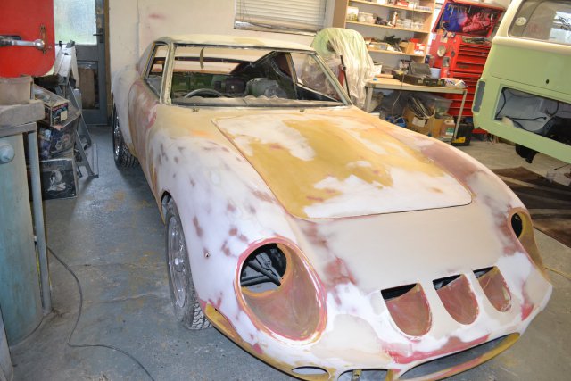

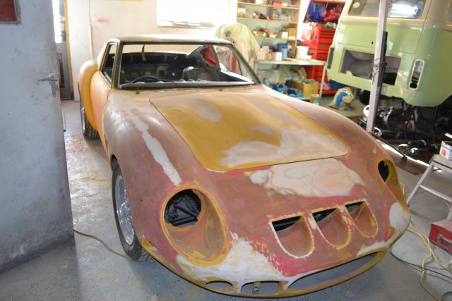

Well I did manage to get a little bit more done this week,
I have started shaping the body up, the rear quarters were not too bad just needed the original flash lines sorting out, the doors are quite bad they need a couple of skims to straighten them up I have a feeling it is where the skins were bonded on and maybe clamped in to position.
The bonnet will be used as  a plug to make a new one, as I mentioned it has been extended toward the scuttle/ screen and it is really very heavy for it.
I have just roller primed the bonnet for now, this will be blocked and the sprayed with high build, I am hoping to take the mould from a primed and then polished surface but I will see how well it turns out.
Pics.

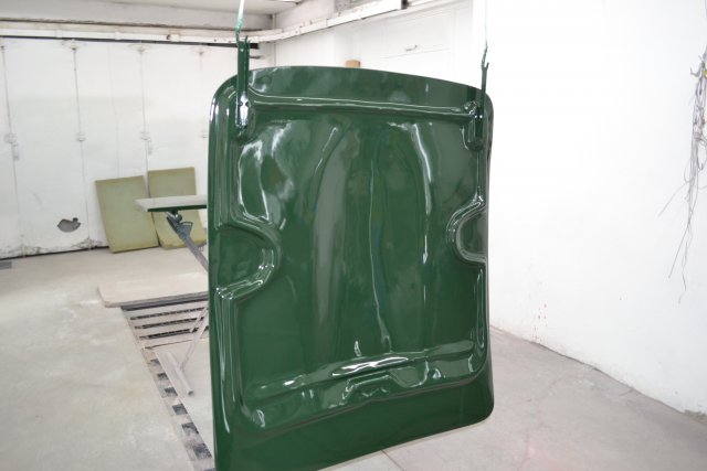

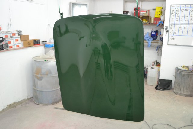

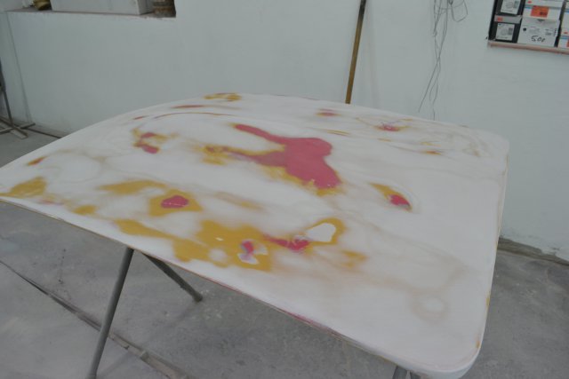

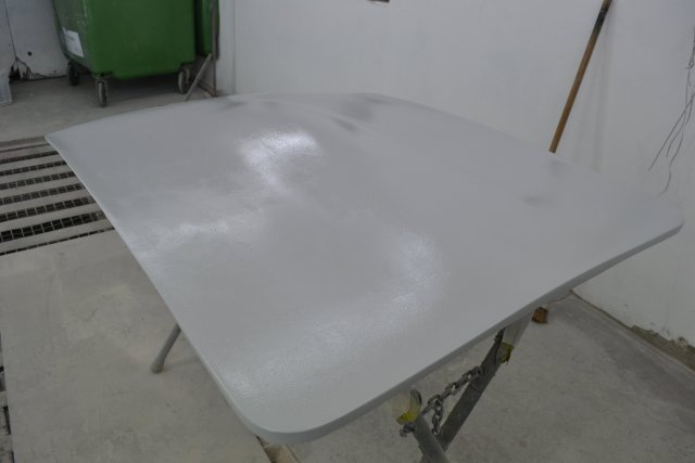

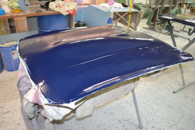

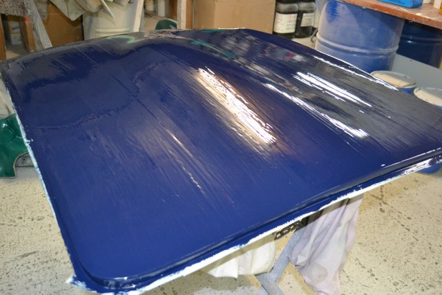

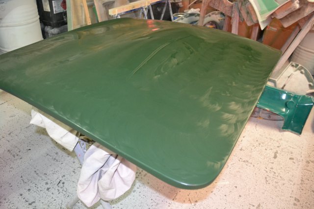

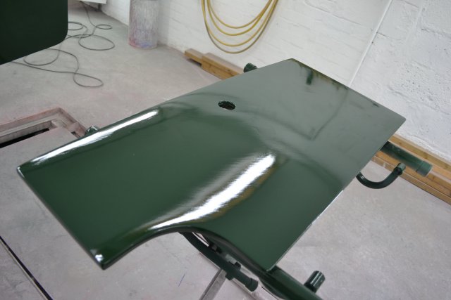

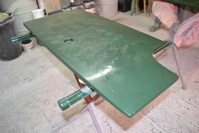

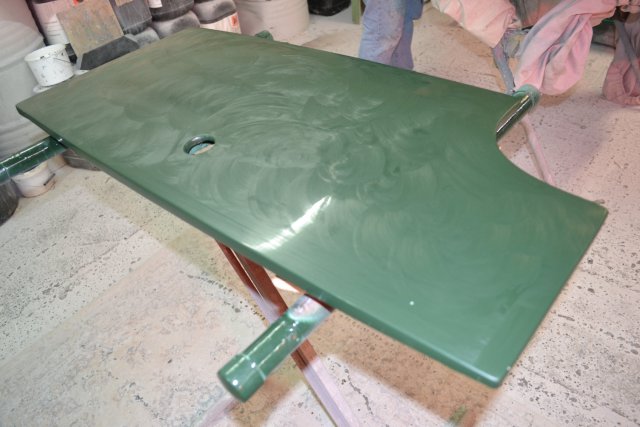

I have managed to get a bit more done on my car,

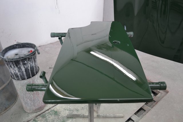

The bonnet had been extended in to the scuttle by about four inches or so, the trouble was the previous owner had used steel to do it and with all the filler used it had made the thing really heavy.

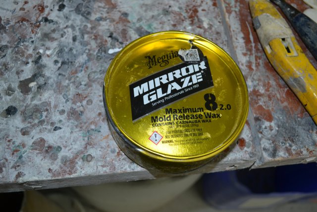

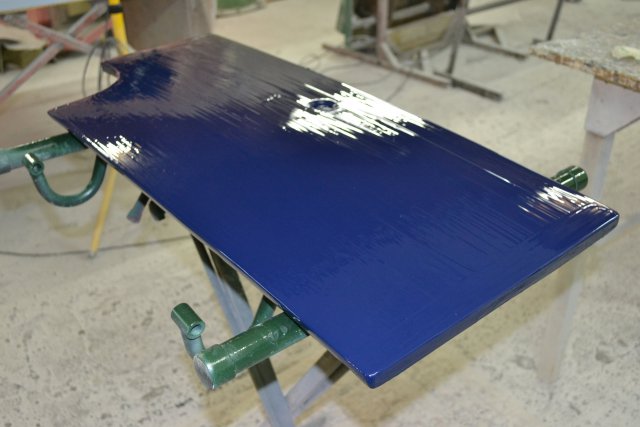

The boot lid was also a mess so I decided to take moulds from them and produce better quality ones, my knowledge of mould making is limited but I do have a mate who makes GT40 bodies for a living who is local to me so I spent a few days with him to get a better understanding of what's involved.
This may be old hat to some of you so you can skip the next few photos if desired.
The 1st thing I had to do was get the bonnet and boot all painted up and nice n shiney, I had some old BRG left over from a repaint, it is solid 2K but does flat n polish to a good finish.
Reply to this topic...
