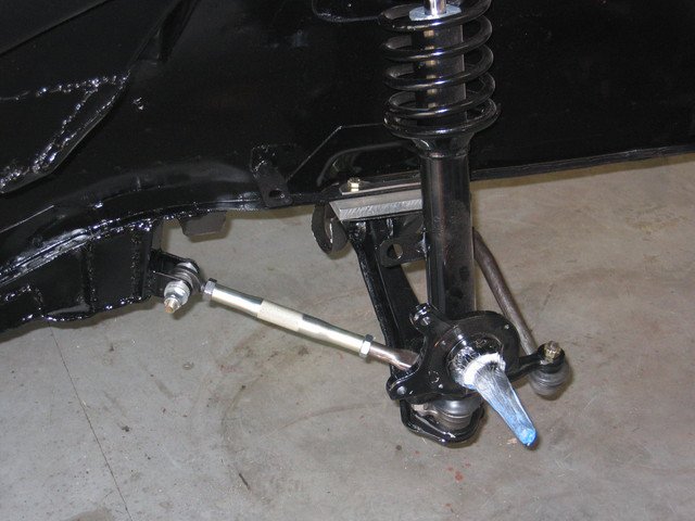

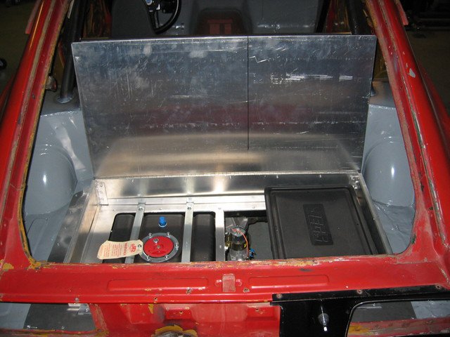

Since my last post we finished the cage (what a joy that was!), we also started the fuel system and real hatch area mods. We also finished the steering mods and welded in our new engine cross member.
Here are some new photos for you all to take a gander at.

Don’t worry about the light coloured engine bay – most of the race cars out here are painted white inside because it is good to spot leaks and any stress cracks show up nice and early.
Looks like you had to cut up the firewall a bit to get the SBF sitting that low and far back – well done good placement of heavy components will make a better race car.
That was our thoughts exactly! I got the idea from a NASCAR race I went to and the engine bay was grey, though it looks clean so off to the home center for some grey Rustolium.
The firewall actually did not need to be cut for motor clearance, there was some rust in the fender well under the battery tray that ended up taking out a 18' section of the firewall.

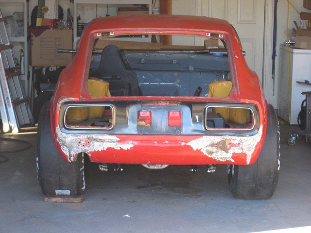

We just started the bodywork, we decided to fabricate a new rear roll pan because ours was soooooooo bad. I will post some more pics soon.
